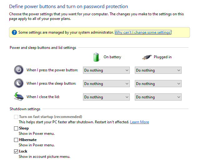

    Why is my option to "Turn on fast startup" greyed out?
    Pls Answer

  3. Turn off Fast Startup
    Hi Michel,
    Please take note that you must be signed in as an Administrator to be able to turn fast startup on or off. Fast startup requires that
    hibernate be enabled. If you disable hibernate, then it will also disable fast startup.
    Steps on how to manually turn off the Fast Startup
    • Open the Control Panel (icons view), and click on the
      Power Options
      icon.
    • Click/tap on the Choose what the power buttons do link on the left side
    • Click/tap on the Change settings that are currently unavailable link at the top
    • If prompted by UAC, click/tap on Yes
    If the option for turning off the Fast Startup is not available, then changing the registry key maybe required.
    Note: Please note that configuring Registry key requires extra care as it might cause another issue with your system.
    • Type RegEdit in the search field on your Task bar
      and open the Registry tool.On the left pane of the Registry window, locate
      HKEY_LOCAL_MACHINE\SYSTEM\CurrentControlSet\Control\Session Manager\Power.
    • On the right pane of the said location, check if the HiberbootEnabled
      is available. If not, we need to create it by clicking the right key of the mouse, select New
      and click on DWORD (32 bit) Value.
    • Replace it with the word HiberbootEnabled under Name
      column.Data value must be zero (0) that will represent as the Fast Startup is turned off.
    • Restart the computer for the changes to take effect.
