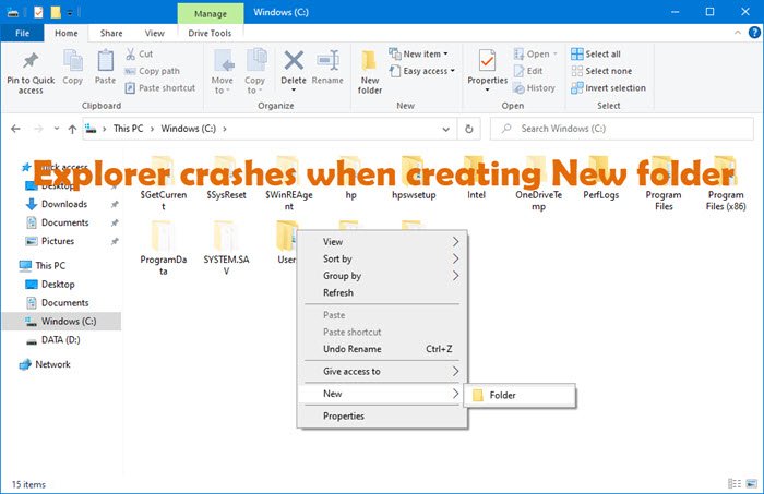

    If when you are trying to create a New Folder using the context menu, File Explorer freezes or crashes in Windows 10, then this article is sure to help you.
    File Explorer crashes or freezes when creating New folder
    File Explorer crashes or freezes when creating New folder in Windows 10 Explorer-crashes-or-freezes-when-creating-New-folder.jpg
    These are the things you can do is creating New Folder causes Explorer to freeze in Windows 10:

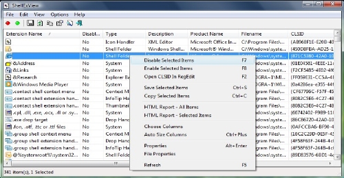

    Check the Check installed Add-ons – if any. They are usually the culprit! Check if you have installed any helpers or add-ons to your explorer. Uninstall or disable them. Often, even 3rd-party shell extensions can cause Explorer to crash on particular actions. Several programs add items to the right-click context menu. To see them in detail, you may download the freeware utility ShellExView from nirsoft.net.
    File Explorer crashes or freezes when creating New folder in Windows 10 shellxv.jpg ​
    It will let you view & disable suspect 3rd party shell extensions. Using the trial & error method, you may disable/enable the extensions to try and identify if any of them are causing a problem. ShellExView can also be used for solving context-menu problems in Explorer, like, say, if the right-click is slow.

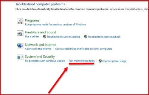

    5] Run System Maintenance Troubleshooter
    File Explorer crashes or freezes when creating New folder in Windows 10 System-and-Security-troubleshooter-500x321.jpg
    If File Explorer is crashing while creating a New Folder, try running System Maintenance Troubleshooter to fix the issue. To do that, follow the given steps:
    1. Launch Control Panel from the Start Menu.
    2. Click Troubleshooting
    3. From System and Security section, click Run maintenance tasks and follow the on-screen instructions to fix the issue.
    Alternatively, in Windows 10, to run the System Maintenance Troubleshooter. Open Run, type the following and hit Enter:
    %systemroot%\system32\msdt.exe -id MaintenanceDiagnostic
    After completion of the task, restart your computer, try creating a New Folder in File Explorer, and check if the issue persists.
