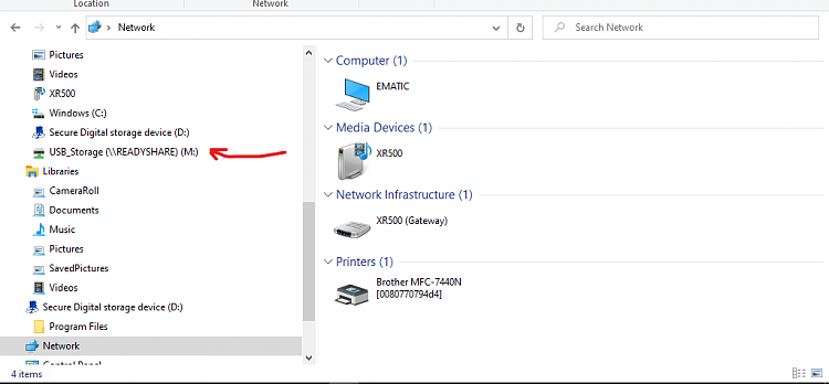

    W10-32 explorer stops responding on mapped drive access.
    If I wait long enough ... several minutes, it seems to access ... finally. Copying files from mapped drive ... same thing ... stops responding but wait long enough and it happens. No such problems with other machines on network. No such problem in the past (worked fine at one time).
    W10-32 v. 1909 Build 18363.535
    Network drive mapped to M:
    DISM and SFC routines to not reveal any problems.
    Now, it gets really weird. UNmap drive. Open Explorer. Network drive not found under NETWORK, but still shows as a mapped drive. See screenshot.
    File explorer not responding due to mapped network drive not connected. 262862d1578856533t-w10-32-explorer-stops-responding-mapped-drive-access-w32issue.png
    I really don't think this is right. If UNMAPPED .. should not show this way. It should show in NETWORK since it is shared. If I click on it as shows AS mapped, Explorer opens it, and it does not stop responding. Access to the drive works perfectly.
    Any help is appreciated in advance.
