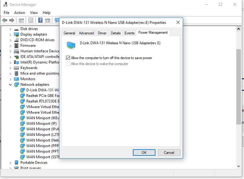

    Upon some googling etc I came to conclusion may be power management of my USB wifi adapter could be a reason for this.
    See the screenshot below. finding the reason for being disconnected from wifi network fb585163-8971-4b7a-8cd0-5bf8b1fd9e53?upload=true.jpg
    So now I have disabled power management i.e. unticked allow the computer to turn off this device to save power.

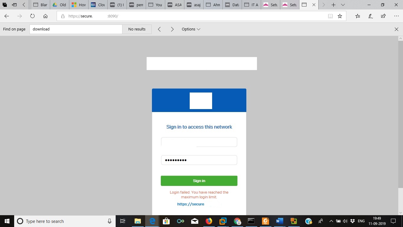

    What else should I check because there is a maximum login limit in my network i.e. if I exceed login to a certain number of times then I am disabled to login for the day.
    finding the reason for being disconnected from wifi network d83691f3-0ded-44ec-8a7a-c9ff2bca834d?upload=true.jpg
    What more should I check at my end?
