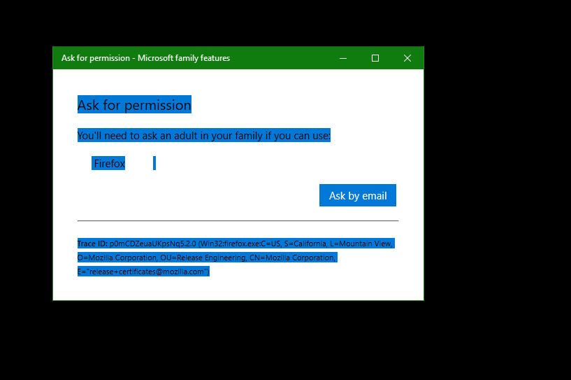

    Firefox gives this error when family safety is on and parent did not block browsers Ask for permission You'll need to ask an adult in your family if you can use: Firefox Ask by email Trace ID: p0mCDZeuaUKpsNq5.2.0 Win32:firefox.exe:C=US, S=California, L=Mountain View, O=Mozilla Corporation, OU=Release Engineering, CN=Mozilla Corporation, E="*** Email address is removed for privacy ***" Firefox gives this error when family safety is on and parent did not block browser 231ed60c-e123-4f00-b6fa-5f2534acb695?upload=true.png

  2. Ian Ser Win User
    Windows 10 Family Safety is blocking my browser!!!
    Can you confirm if you are out of the Family Safety feature on your parent's account on this
    link? If you've confirmed that you're no longer on the list of monitored child accounts, we suggest deleting the Family Safety folder. Here are the steps:
    • Press Windows key + E on your keyboard.
    • On the address bar, type this address C:\ProgramData\Microsoft\Windows\Parental Controls and press
      Enter.
    • Delete all contents of the Parental Controls folder.
    • Restart and see if the issue is resolved.
    Let us know how it went for you.
    Ian Ser, May 26, 2020
