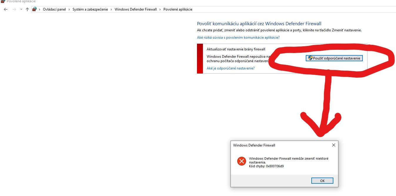

    Firewall cant be turned on (error 0x800706d9)
    hello I have this problem, when I try to change settings on firewall in controll panel, I cant change anything. After I press the button (in the red circle, see the picture) this window pops up.
    Thanks for any help
    Firewall cant be turned on (error 0x800706d9) 99597f25-1d0c-4668-96fb-4973eaf28c57?upload=true.jpg

  3. Mala_S Win User
    Windows Defender Firewall error code 0x800706d9
    Hi AnudieKatz.
    Since you are facing an issue with the Windows Defender firewall, I would like to ask you few questions to get a better picture.
    1. Are you using any other Anti-virus software?
    2. Since when are you facing this issue?
    3. Have you tried installing Picture viewer and Calendar app after it getting uninstalled?
    Based on your information, I would like to inform you that if you are using third party anti-virus program Windows defender will automatically turn off from your system you will not able turn it on manually.
    Let’s try simple troubleshooting steps and check if this helps in resolving the issue. Follow the below methods.
    Method 1: Check the following services and ensure it is started.
    1. Press Windows and R key together on your Keyboard.
    2. Type Services.msc and hit Enter.
    3. Search for the following services:
    • Base filtering engine Service
    • Remote Procedure Call Service
    • Windows defender firewall service
    4. Start the above services and reboot the device.
    Method 2: I would suggest you to try running the troubleshooter to enable the firewall. Use the below link to run the troubleshooter.
    https://support.microsoft.com/en-us...agnose-and-fix-problems-with-windows-firewall
    If you are still facing the same issue after following the above steps, revert with the details asked.
    Hope it helps.

  4. Firewall cant be turned on (error 0x800706d9)
    Windows 10 account problems and Windows firewall problems get the error code 0x800706D9
    Sorry for the inconvenience caused.
    The error “0x800706D9” will result when the Windows Firewall/ICS service is in a stopped state.
    As you are facing issues with the Xbox app and the Windows Firewall I suggest you to follow the below methods and check if it helps.
    Method 1:
    I suggest you to download and run the app troubleshooter from the below link and check.
    The app troubleshooter will automatically notify you if there’s a problem with an app and try to fix the problem. If you continue experiencing problems with an app, or if you're unable to open the Store, try running the
    Apps troubleshooter.
    This tool can automatically identify and fix some problems with apps and the Store.
    http://windows.microsoft.com/en-us/windows-10/run-the-troubleshooter-for-windows-apps
    Method 2:
    This error is by design. Most users who want to disable the Windows Firewall will use the Windows Firewall wizard and set the firewall to "Off" rather than disabling the Firewall/ICS service directly. When the Windows Firewall/ICS service is stopped you
    cannot even launch the Windows Firewall wizard.
    Follow the below steps and check if it helps.
    • Press Windows Key + R for Run.
    • Type devmgmt.msc and then Enter.
    • Right click on the Windows firewall and then set it to
      Automatic.
    Hope this information is helpful. If you need further assistance, we’ll be glad to assist you
