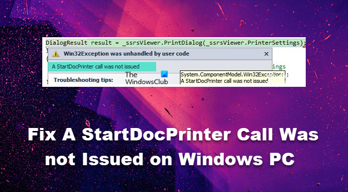

    Some HP Printer users are unable to print as when they try to do the same, an error message that says A StartDocPrinter call was not issued pops up. This issue is obviously annoying and requires fixing, that is what, we are going to do in this article. We will be seeing some simple solutions […]

  3. Cannot print to an HP M452nw over the network - StartDocPrinter Call was not issued
    I have a workstation that will not print to an HP M452nw over the network. If I try and print a test page, it errors. If I try and print from notepad, I get an error that says: StartDocPrinter Call was not issued.
    I have tried what was suggested in this article:
    https://answers.microsoft.com/en-us...t-issued/911e0459-c088-4812-9c38-c970dea06ae0
    I've tried using the solution here: https://answers.microsoft.com/en-us...-failure/9af86564-6c97-42ea-9a58-8b6106e596c2
    I've tried manually deleting drivers, printers, and ports, in device manager, the registry, print managment, and print server properties in in Devices and Printers in control panel.
    I've tried setting the printer up as a TCP/IP device. I've tried using the HP install suite to install it. None of this worked. Restarting the print spooler does nothing.
