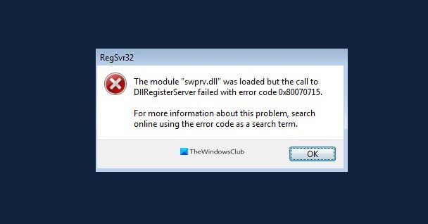

    This article lists possible solutions to fix DLLRegisterserver failed with Error 0x80070715 in Windows 10. In most cases, the error occurs when the Volume Shadow Copy does not start or is disabled.
    Fix DLLRegisterserver failed with error code 0x80070715 in Windows 10 0x80070715.jpg
    If you receive DLLRegisterserver failed with Error 0x80070715, try the following suggestions:

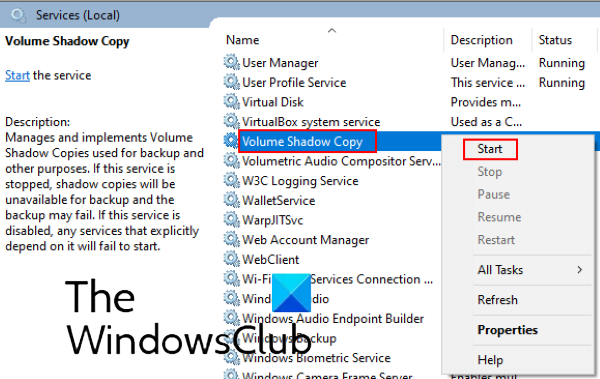

    1] Enable the Volume Shadow Copy
    You can enable the Volume Shadow Copy using the Services app of Windows 10.
    Fix DLLRegisterserver failed with error code 0x80070715 in Windows 10 DLLRegisterserver-failed-Error-0x80070715_1.png
    Follow the below-listed steps:
    1. Launch the Run window by pressing Windows and R keys.
    2. Type “services.msc” and click OK.
    3. In the Services window, scroll down to view Volume Shadow Copy. Once you find it, right-click on it and select Start.
    Did it help? If not, try the next solution.
