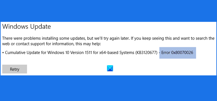

    Fix Error 0x80070026 for Windows Update or System Restore Windows-Update-error-0x80070026-1.png ​
    This post suggests ways to fix error 0x80070026 for Windows Update or System Restore. Several users have faced this issue that when they try to update Windows or perform a System Restore – the process doesn’t complete and they receive this 0x80070026 error. Error 0x80070026 for Windows Update This Windows Update error code 0x800700 normally […]

    Still no luck. Here's what I did:
    1. Ran Windows update troubleshooter. It reported "Problems found" and "Windows Update components must be repaired" with "Fixed" and a green check mark.
    2. Let the Windows update automatic process run. Once again the updated downloaded installed about 99% and reported "Cumulative Update for Windows 10 Version 1511 for x64-based Systems (KB3156421) - Error 0x80070026."
    3. Re-ran Windows updated troubleshooter. Reported the same as step 1 above.
    4. Ran Windows update standalone. Once again the update appeared to install, but then reported that the "Security Update for Windows (KB3156421)" was not installed.
    5. Ran svc /scannow and it reported "Windows resource Protection did not find any integrity violations"
    6. Re-ran Windows updated troubleshooter. Reported the same as step 1 above.
    What do you suggest next? Thanks...

    Windows Update KB31566421 will not install - Error 0x80070026
    Before doing the Clean Boot I went back and performed the initial process, using the Windows File Explorer and Task Manager to verify the steps.
    net stop wuauserv (successful)
    net stop cryptSvc (successful)
    net stop bits (successful)
    net stop msiserver (already stopped)
    Used the Windows File Explorer to rename directories.
    SoftwareDistribution (renamed successfully)
    catroot2 (had to stop cryptSvc again to rename this directly)
    Started up the services above and rebooted. The update downloaded, but did not install. Still reporting the Error 0x80070026.
    Followed the Clean Boot procedure and restarted. Once again the updated downloaded installed about 99% and the reported the Error 0x80070026.
    Attempted to install the update from the saved downloaded version from the clean boot environment as I did earlier. Once again the update appeared to install, but then reported that the "Security Update for Windows (KB3156421)" was not installed.
    Any other suggestions? I see that others are experiencing the same issue with this update.
    Thanks...
