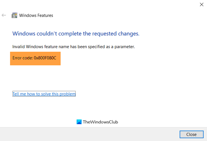

    Fix Error 0X800F080C when installing .NET Framework on Windows 10
    In this post, we will see how to fix 0X800F080C .NET Framework error on Windows 10. which you may face while installing or setting it up. The error indicates that there may be some corrupted files or corrupted .NET Framework dependencies in the system. Users facing this issue are not able to install the missing .NET Framework packages and run some specific program files on their system.
    Fix Error 0X800F080C when installing .NET Framework on Windows 10 0X800F080C.png
    If you face this issue, try the following methods to solve it:
    1. Enable .NET Framework in Clean Boot State.
    2. Run the .NET repair tool.
    3. Run SFC scan.
    4. Run DISM scan.
    5. Download .NET Framework offline installer.

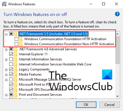

    1] Enable .NET Framework in the Control Panel
    Fix Error 0X800F080C when installing .NET Framework on Windows 10 0X800F080C-.NET-Framework-error-1.png
    Many apps or software require a specific version of the .NET Framework. Sometimes, users encounter a message while running an app or software, “This application requires .NET Framework to run, but that version is not installed on your system.”
    You can enable the .NET Framework version in the Control Panel – even better – do it in Clean Boot State.
    Type Windows Features in the Windows 10 search box and click “Turn Windows features on or off.” Now, select the required version checkbox and click OK.
    This will install the .NET package on your system. You should be connected to the internet while enabling the .NET Framework using Windows Features. Reboot your device if you will get such a prompt message on the screen.
    Do note that you need not select the checkboxes for Windows Communication Foundation (WCF) HTTP Activation and Windows Communication Foundation (WCF) Non-HTTP Activation, as these features are required by developers or service administrators.
