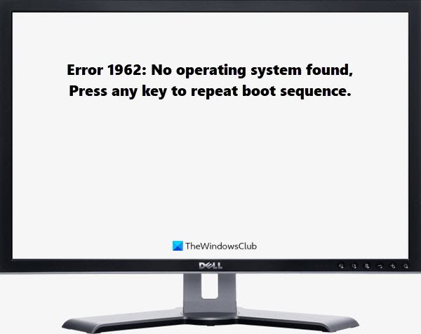

    If you are using a Lenovo desktop or laptop, you may encounter – Error 1962, No operating system found, Press any key to repeat boot sequence when you start your computer. There can be multiple reasons for the problem, but some of the most common reasons are faulty Hard drives, incorrect BIOS Settings, malfunctioned cables, etc. In this article, we are going to fix this error with the help of some solutions.
    Error 1962: No Operating System found
    Fix Error 1962, No operating system found on Windows 10 computers Error-1962-No-operating-system-found.jpg
    These are the things you can do to fix the No operating system found error at boot-time:

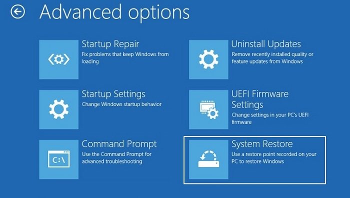

    2] Perform System Restore usingInstallaton Media
    Another thing you can do to fix the issue is System Restore, but you cannot use the conventional method since you can’t open your computer. Therefore, follow the given steps to do System Restore.
    This will only work if you have already created a System Restore Point.
    Fix Error 1962, No operating system found on Windows 10 computers System-Restore-Advanced-Recovery.jpg
    1. Download the ISO version that you have installed on your system and use the mentioned tools to create a Bootable USB drive.
    2. Boot your system using the installation media
    3. Now, click Repair > Troubleshoot > Advanced options > System Restore in order to run System Restore

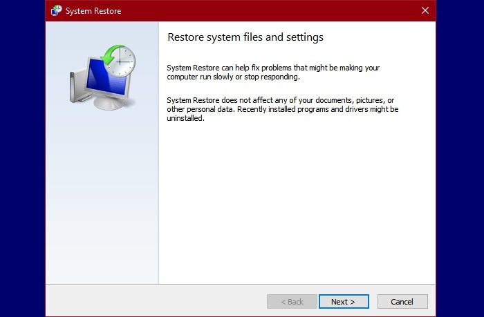

    4. It will open the System Restore window, where you need to select a System Restore Point and click Next.
    Fix Error 1962, No operating system found on Windows 10 computers system-restore-next.jpg
    Finally, follow the on-screen instructions to do System Restore and check if it fixes the Error 1962.
