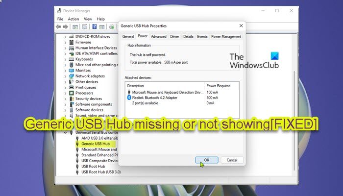

    Fix Generic USB Hub missing or not showing in Windows 11/10
    Fix Generic USB Hub missing or not showing in Windows 11/10 Generic-USB-Hub-missing-or-not-showing.jpg ​
    For one reason or the other, the USB ports may stop working on your Windows 11 or Windows 10 computer, and you may notice that the Generic USB Hub device is missing or not showing in Device Manager – then this post provides the most suitable solutions affected PC users can apply to resolve the […]

  4. Fix Generic USB Hub missing or not showing in Windows 11/10
    USB HUB
    Incompatible USB hub driver is one of the possible reasons why this issue is happening. We recommend uninstalling the USB Root Hub driver and see if it helps. Follow the stepes below:
    • Open Device Manager.
    • Double-click Universal Serial Bus controllers to expand.
    • Right-click USB Root Hub, then click Properties.
    • Go to the Driver tab.
    • Click Uninstall.
    • Restart your computer.
    Note: Restarting your computer will automatically reinstall a generic driver for your computer. Also, we suggest connecting your USB hub while performing the steps.
    If the issue still persists, let's disable the USB selective suspend settings thru Power Options to resolve the issue. Follow the steps below:
    • Type Power Options in the search box, then press Enter.
    • Locate USB settings > USB selective suspend settings.
    • Select Disable.
    Keep us in the loop with the result.
