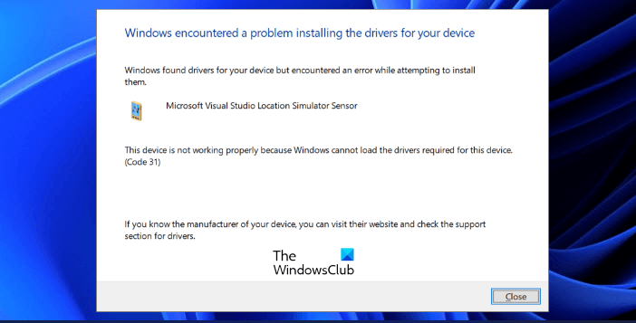

    Some users are complaining that Microsoft Visual Studio Location Simulator Sensor is not working on their Windows computers. Some of them have tried updating the device driver from the Device Manager. But when they updated the driver, they received the following Device Manager error message: This device is not working properly because Windows cannot load […]

    Hello every body,
    I have just found a problem with Microsoft Visual Studio Simulator Sensor.
    Device Manager -> Sensors -> Microsoft Visual Studio Simulator Sensor.
    " This device is not working properly because Windows cannot load the drivers required for this device. (Code 31)
    {Operation Failed}
    The requested operation was unsuccessful. "
    I have tried to fix the problem with "Update Driver" but it didn't work.
    How could I fix the problem ?

    Hey Angelo,
    Unfortunately, the Microsoft Visual Studio Simulator Sensor was removed from the VS 2017 installer, as stated by Luke Westendorf. This could be left over from VS 2015, if you had it previously. You should be able to remove it and without issue.

    "Microsoft Visual Studio Location Simulator Sensor" not working after clean install Windows 10 (1709)
    Hi.
    I did what you suggested and, as another person commented (with pictures), does not fix the issue.
    What fixed: removing the "sensor".
