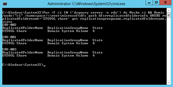

    We can verify the replication by running the following command.
    For /f %i IN ('dsquery server -o rdn') do @echo %i && @wmic /node:"%i" /namespace:\\root\microsoftdfs path dfsrreplicatedfolderinfo WHERE replicatedfoldername='SYSVOL share' get replicationgroupname,replicatedfoldername,state
    The states should translate as below
    0 = Uninitialized
    1 = Initialized
    2 = Initial Sync
    3 = Auto Recovery
    4 = Normal
    5 = In Error

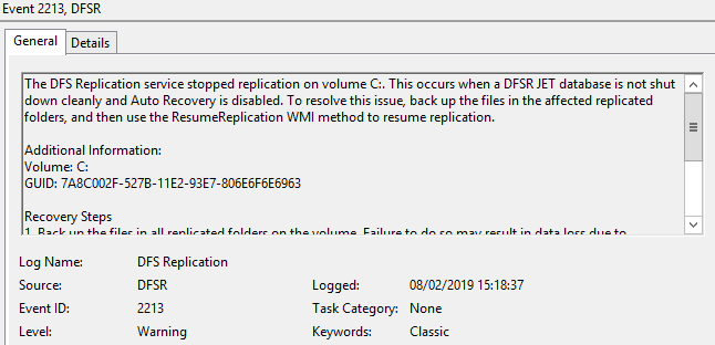

    In my case, I have noticed that the newly promoted server was showing 2 and the main domain controller was showing “No Instance(s) Available” which is quite strange. Here you would need to look into the original Active Directory server for any problems and you would see a warning on the DFS Replication under Applications with Event ID 2213 as below.
    Fix: Missing Sysvol and Netlogon after domain controller promotion dfsr_1.png
    It says that the DFS Replication service stopped replication on volume C:. This occurs when a DFSR JET database is not shut down cleanly and Auto Recovery is disabled.
    What we need to do here is from the event viewer take note of the volumeGUID and run the below command and replacing GUID-NUMBER with your GUID.
    wmic /namespace:\\root\microsoftdfs path dfsrVolumeConfig where volumeGuid="GUID-NUMBER" call ResumeReplication
    This will restart the replication and recreate the database. This can be seen with an event with ID 2214 saying The DFS Replication service successfully recovered from an unexpected shutdown on volume C:.This can occur if the service terminated abnormally (due to a power loss, for example) or an error occurred on the volume. No user action is required.
    If you run the command to see the state of the replication you will see that the servers are all showing state 4 as below and the both Sysvol and Netlogon will be replicated.
    Fix: Missing Sysvol and Netlogon after domain controller promotion dfsr_3.png
