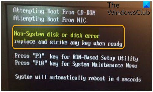

    If when you boot your Windows 10 device, but the boot process fails and you’re confronted with the error message Non-system disk error or disk error on a black screen, you may want to continue reading this post as we will offer the solutions you can try to successfully resolve the issue.
    Fix Non-system disk or disk error Black screen on Windows 10 Non-system-disk-or-disk-error-black-screen.jpg
    You may encounter this error if the computer BIOS cannot find a bootable operating system on any of the storage devices included in its boot path, or it fails to locate the boot disk.
    Similar error messages include Boot device not found, Operating system not found, or Missing operating system.

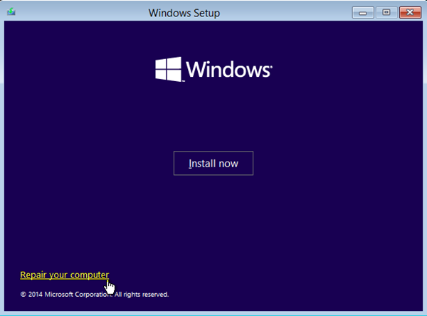

    If for some reason the system partition is set inactive, you may encounter this error. In this case, you’ll need to manually set the system partition as active. Here’s how:
    You’ll need Windows 10 bootable media to carry out this task. On any working PC, create a Windows 10 installation USB drive, if you don’t have one readily available.
    You can create the Windows 10 installation media on a Linux or Mac computer if those are what you have access to. Then, proceed as follows:
    Fix Non-system disk or disk error Black screen on Windows 10 repair-your-computer-windows-setup-600x444.png
    • Boot the faulty PC using the Windows 10 installation media.
    • The Windows Setup dialog box will appear.
    • Set the Time and currency format, Keyboard or input method, and the language to install.
    • Click Next.
    • Click on Repair your computer from the lower-left corner.

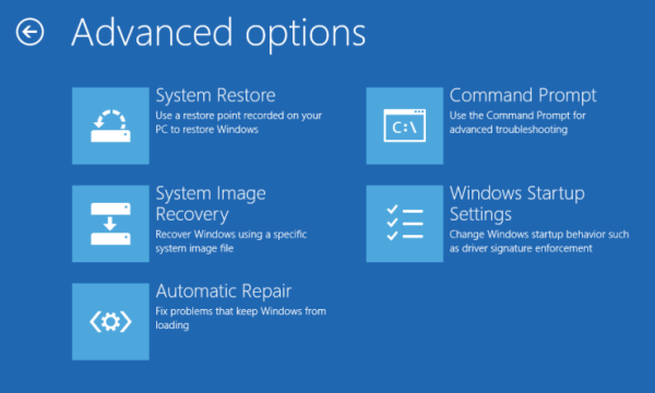

    • From the Choose an option screen, click on Troubleshoot.
    • Click Advanced Options in the Troubleshoot screen.
    • In the Advanced Options screen, click Command Prompt.
    • In the CMD window, type the following commands and hit Enter after each line:
    Diskpart
    List disk
    Select disk 0
    The System drive is always configured as disk 0. However, enter the correct number in your own case.
    List partition
    Select partition 1
    The System partition is always configured as partition 1. However, enter the correct number in your own case.
    Active
    Exit
