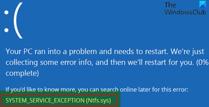

    The system file Ntfs.sys may get damaged or corrupted and consequently lead to a Blue Screen of Death error that prevents you from booting into Windows 10. The stope code could be NTFS_FILE_SYSTEM or SYSTEM_SERVICE_EXCEPTION. In this post, we provide the most suitable solutions to resolve the SYSTEM SERVICE EXCEPTION (Ntfs.sys) Blue Screen error on Windows 10.
    Fix Ntfs.sys Failed BSOD Error on Windows 10 SYSTEM_SERVICE_EXCEPTION-Ntfs.sys-Blue-Screen.png
    The most likely culprit to this error could be a corrupt NTFS driver. Ntfs.sys is a system file associated with the NTFS system. Bad sectors on the hard drive or incompatible device drivers, depletion of non-paged pool memory, etc, can also result in this BSOD error.
    If you’re faced with this SYSTEM SERVICE EXCEPTION (Ntfs.sys) Blue Screen, then one of these suggestions is likely to help you:
    1. Update device drivers
    2. Uninstall third-party security software
    3. Run SFC scan
    4. Run CHKDSK
    5. Run Memory Test
    Let’s take a look at the description of the process involved concerning each of the listed solutions.
