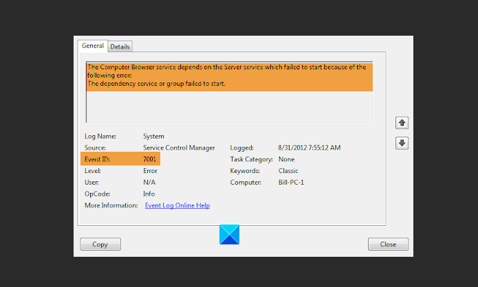

    The Computer Browser service depends on the Server service which failed to start because the dependency service or group failed to start.
    You could see the error occurring for:
    • TCP/IP NetBIOS Helper Service
    • Computer Browser service
    • FTP Publishing Service
    • World Wide Web Publishing Service
    • Site Server LDAP Service
    • Microsoft NNTP Service
    • Microsoft SMTP Service
    • Etc.

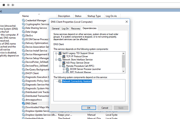

    1] Find dependencies of a Windows Service
    • Fix Service Control Manager Event ID 7001 on Windows 10 Windows-10-Service-Dependencies.png
    Identify the Service that has failed and find the Dependencies of that Service.
    You need to open Windows Services Manager, select the service in question, right-click on it, and select Properties.
    Switch to the Dependencies tab.
    Here you can see a list of services on which this service depends and other services which depend on this service.
    Make sure that these are started.

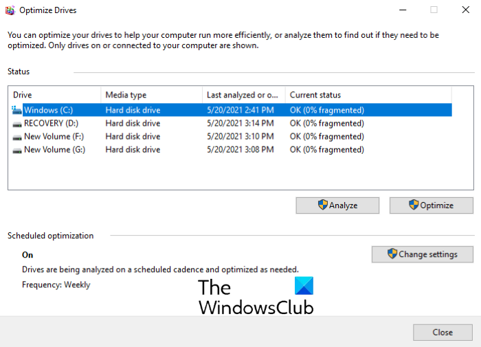

    2] Improve the performance of your system by optimizing the drives
    Drive optimization helps you improve the performance of your computer. Windows 10 comes with a built-in tool, named Defragment and Optimize Drives. You can use this tool to optimize only the NTFS, FAT, or FAT 32 drives.
    Fix Service Control Manager Event ID 7001 on Windows 10 service-control-manager-error_7001.png
    Type Optimize drives in the Windows 10 search box and click on the app to launch it. After launching the app, you will see the percentage of fragmentation of each disk on your computer in the Current status column. Disk fragmentation should always be less than 10%. If you find any of your disk(s) fragmented more than 10%, it needs to be optimized. To optimize the drive, select it and click on the Optimize button.
    If the Defragment and Optimize Drives tool is not showing any of your system drive(s), it is because of the following reasons:
    1. The disk is already in use by another program.
    2. You have formatted the disk using a file system other than NTFS, FAT, or FAT 32.
    3. The drive is the network drive.
    4. The disk has some error or may be corrupted. In this case, we suggest you repair the drive and then try to optimize it using the Disk Defragment tool.

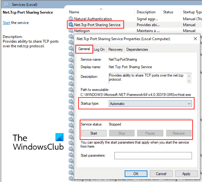

    4] Enable the Net.Tcp Port Sharing Service
    If resetting the TCP/IP or Internet Protocol did not fix the issue for you, try this method. Many users have reported that after starting the TCP.Net Port Sharing Service, they got rid of the error Service Control Manager error 7001.
    Fix Service Control Manager Event ID 7001 on Windows 10 service-control-manager-error-7001.png
    Follow the below-listed instructions:
    1. First, you have to open the Services Management Console. For this, type services.msc in the Run dialog box and click OK.
    2. Now, scroll down the list and locate Net.Tcp Port Service.
    3. Double-click on it and select its startup type Automatic from the drop-down menu.
    4. You will see the status of the service. If it is stopped, click on the Start button and then click OK.
    5. Restart your computer and see if it helps.
    If this did not resolve the issue, move on to the next method.

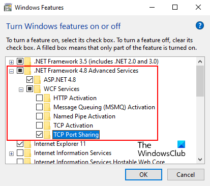

    5] Disable TCP Port Sharing feature from Control Panel
    Many users have also reported that disabling the TCP Port Sharing feature from Control Panel helped them solve the issue.
    Fix Service Control Manager Event ID 7001 on Windows 10 fix-service-control-manager-error-7001.png
    Follow the instructions given below:
    1. Type Turn Windows Features On and Off in the search box of Windows 10.
    2. Click on the app to launch it.
    3. Expand .NET Framework 4.6 Advanced Services. You will find WCF Services in it. However, I found the WCF Services in .NET Framework 4.8 Advanced Services.
    4. Expand WCF Services.
    5. Disable the TCP Port Sharing feature by unchecking the box adjacent to it.
    6. Click OK to save the setting.
    It should help.
