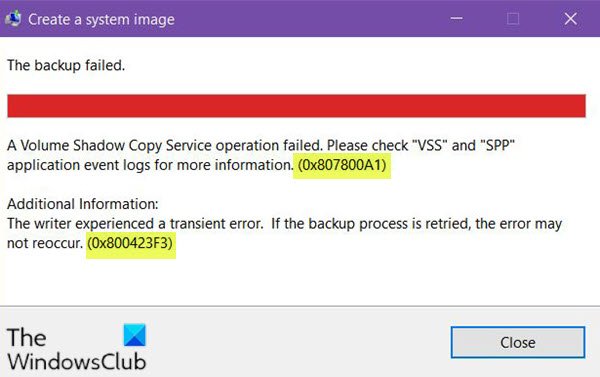

    When you encounter this issue, you’ll receive the following full error message;
    Create a system image
    The backup failed.
    A Volume Shadow Copy Service operation failed. Please check “VSS” and “SPP” application event logs for more information. (0x807800A1)
    Additional Information:
    The writer experienced a transient error. If the backup process is retried, the error may not reoccur. (0x800423F3)

    The logs for these can found with the Event Viewer. Run eventvwr.msc to open it. In the Event Viewer, you can check the Application log for any ERROR reported by these services. VSS errors will appear in the Application Log as entries with a source labeled VSS and SPP for Software Protection Service.
