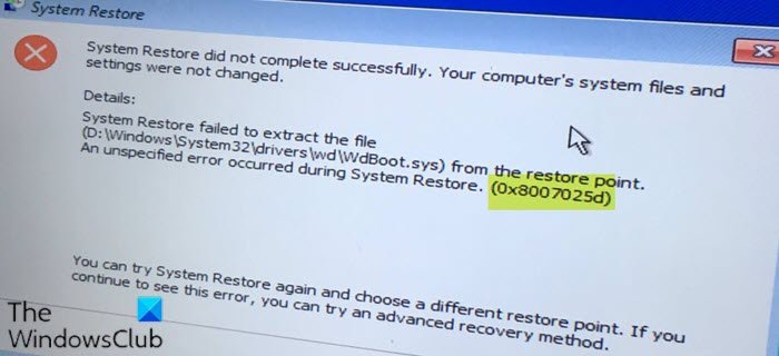

    If when you try to perform a system restore but receive the error code 0x8007025d, then this post is intended to help you. When you encounter this issue, you’ll receive the following full error message:
    System Restore did not complete successfully. Your computer’s system files and settings were not changed.
    Details:
    System Restore failed to extract the file
    (D:\Windows\System32\drivers\wd\WdBoot.sys) from the restore point.
    An unspecified error occurred during System Restore. (0x8007025d)
    You can try System Restore again and choose a different restore point. If you continue to see this error, you can try an advanced recovery method.
    Fix System Restore error 0x8007025d on Windows 10 System-Restore-error-0x8007025d.jpg
    The accompanying error codes could also be 0x80070017, 0x8007018b or 0x800701b1. You’ll encounter this error if the system cannot read, or write to execute the operation. The error may also occur when there are some corrupt system files present on your system. These corrupt system files prevent the system from reverting to an earlier restore point because the files are not compatible with the operating system. In this case, it is WdBoot.sys, which is the Microsoft antimalware boot driver OS file.

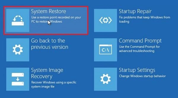

    4] System Restore from Advanced Recovery Environment
    Fix System Restore error 0x8007025d on Windows 10 System-Restore-Advanced-Recovery-Windows-10-600x329.jpg
    Since it’s probably because of permission issues, the Advanced Recovery Environment offers better support in this case. You can boot into Advanced Startup Options from within Windows or using a Windows 10 Bootable USB drive.
    • Open Windows 10 Settings (Win + I)
    • Navigate to Update and Security > Recovery > Click on Restart now button under Advanced Startup
    • When in Recovery, click on Advanced Options > Troubleshoot > Advanced Options
    • Click System Restore, see if you can go back to an earlier time.
    If this works, you will be all set. But if you cannot, then in the Recovery Environment, you have the option to perform startup repair. Do that, and later try to perform a system restore.
