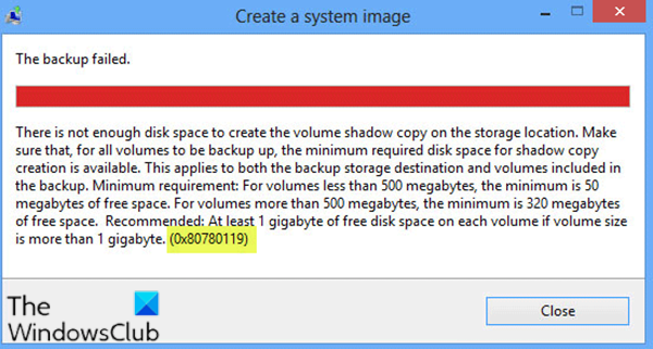

    If when you attempt to create a system image backup on your Windows 10 PC, but the operation fails with an error message – The backup failed, Error code 0x80780119, then this post will help you resolve the issue. Fix The backup failed, 0x80780119 error on Windows 10 Disk-Space-error-0x80780119-when-creating-System-Image.png
    When you encounter this issue, you’ll receive the following full error message:
    The backup failed.
    There is not enough disk space to create the volume shadow copy on the storage location. Make sure that, for all volumes to be backup up, the minimum required disk space for shadow copy creation is available. This applies to both the backup storage destination and volumes included in the backup. Minimum requirement: For volumes less than 500 megabytes, the minimum is 50 megabytes of free space. For volumes more than 500 megabytes, the minimum is 320 megabytes of free space. Recommended: At least 1 gigabyte of free disk space on each volume if volume size is more than 1 gigabyte. (0x80780119)

    The backup failed, Error 0x80780119
    If you’re faced with this issue, you can try our recommended solutions below in no particular order and see if that helps to resolve the issue.

    7] Create new System Volume
    If the System Reserved Partition does not have sufficient space to store a shadow copy, you’ll encounter this error.
    In Disk Management, right-clicking the System Reserved volume and checking its Properties, the volume overall size must remain at least 100 MB. Similarly, this must have at least 40 MB available free space. Since you can’t increase the size of the volume, you can create a new system volume instead. Here’s how:
    • Decide on which drive (let’s say F) you to want to create a new system volume.
    • Next, press Windows key + R to invoke the Run dialog.
    • In the Run dialog box, type cmd and then press CTRL + SHIFT + ENTER to open Command Prompt in elevated mode.
    • In the command prompt window, type the command below and hit Enter.
    bcdboot.exe /s C:\Windows /s F:
    Note: C: is the root drive, and F: is the drive where you want to create new reserved storage.
    • Once the command executes and creates the new drive, type the commands below and hit Enter after each line:
    DISKPART
    DISKPART> select volume F
    DISKPART> active
    Once done, restart the computer and see if the issue is resolved. If not, try the next solution.
