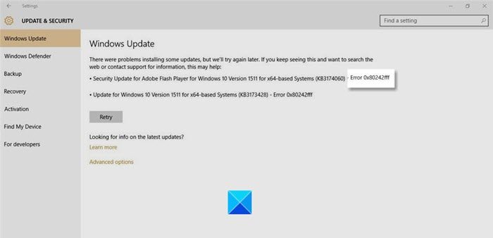

    Error 0x80242fff is generally faced by Windows users when they’re trying to install a Windows Update. Given how important Windows updates are, it is key for users to be aware of relevant errors. Error 0x80242fff is most often faced by users when they are trying to upgrade their system from Windows 8.1 to Windows 10 or when there are any corrupted Windows update components, and since the error window doesn’t show a lot of information about its origins, it can be a little difficult to pin it down and solve it. Thus, today we will be discussing some quick fixes you can try and give a shot if you are facing error 0x80242fff while installing a Windows update.
    0x80242FFF -2145112065 WU_E_UH_UNEXPECTED An update handler error not covered by another WU_E_UH_* code​
    Fix: Windows updates Error 0x80242fff

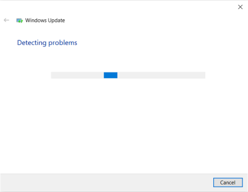

    1] Run Windows Update Troubleshooter
    Fix Windows 10 Updates failed Error 0X80242FFF troubleshooter-running-500x388.png
    Your Windows can be capable of resolving this issue on its own via the update troubleshooter. The Windows Update Troubleshooter packs in itself a handful of repairs that are useful in solving several errors. You should make sure that you are logged into your administrative account before you begin performing the troubleshooting. Here’s how the process goes:
    Open the Run dialog box by pressing the Windows + ‘R’ key combination and type ms-settings:troubleshoot. Pressing Enter will open the Troubleshooting settings.
    Scroll through the options on the right side of the window and visit the additional troubleshooter’s section there.
    Here, select Windows Update and further click on Run the Troubleshooter.
    It will then begin to scan your computer to check if there are any underlying problems. If there are any, Windows will look in its setup for any appropriate solution for it and provide it to you, if available.
    If there was an issue found and you have implemented the subsequent fix, you should restart your computer and check if the error has been resolved.

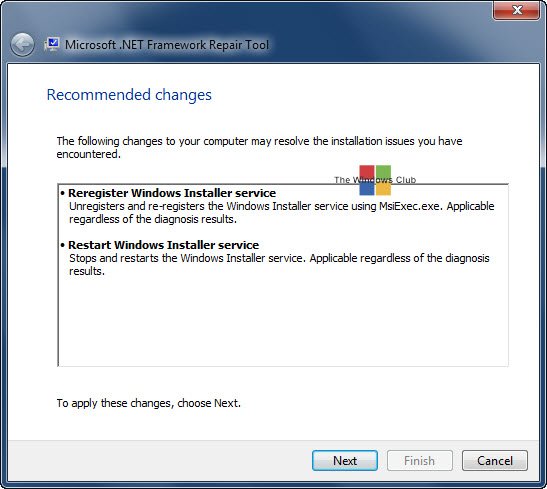

    3] Repair .NET Framework
    Fix Windows 10 Updates failed Error 0X80242FFF net-framework-repair-tool.jpg
    IF this error appears for .NET Framework, then Repair .NET Framework and then run Windows Update.
