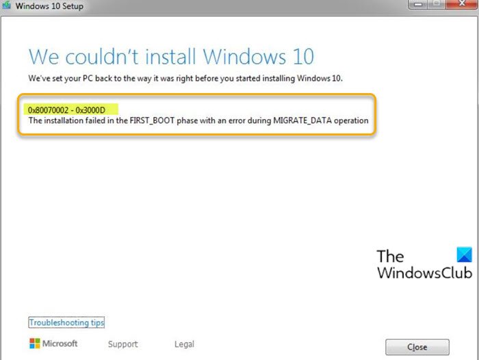

    When you encounter this issue. you’ll receive the following full error message;
    We couldn’t install Windows 10
    We’ve set your PC back to the way it was right before you started installing Windows 10.
    0x80070002 – 0x3000D
    The installation failed in the FIRST_BOOT phase with an error during MIGRATE_DATA operation.
    Windows 10 Upgrade error 0x80070002 – 0x3000D
