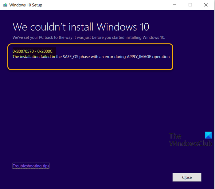

    Some users are encountering the upgrade error 0x80070570 – 0x2000C while upgrading Windows 7/8.1 to Windows 10 – or when installing Windows 10 Feature Upgrades. This post offers the most suitable solutions you can try to successfully resolve this issue.
    Fix Windows 10 Upgrade Install error 0x80070570 – 0x2000C Windows-10-Upgrade-Install-error-0x80070570-0x2000C-500x439.png
    When you encounter this issue. you’ll receive the following full error message;
    We couldn’t install Windows 10
    We’ve set your PC back to the way it was just before you started installing Windows 10.
    The installation failed in the SAFE_OS phase with an error during APPLY_IMAGE operation.
    Error code 0x80070570, ERROR_FILE_CORRUPT indicates that the OS files could have become corrupted.
    Windows 10 Upgrade error 0x80070570 – 0x2000C
