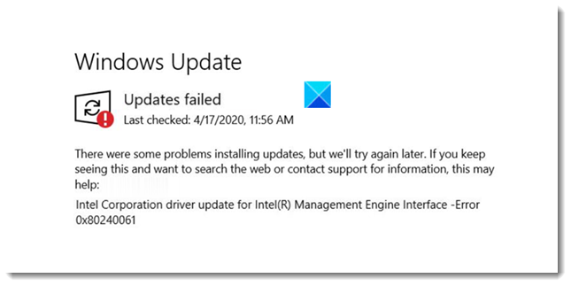

    Upon trying to install Windows Updates, if you see a message with an error code 0x80240061, then this post is sure to help you fix the problem in Windows 10.
    How to fix Windows Update error 0x80240061
    The error code 0x80240061 is usually followed by a message that reads –
    There were problems installing some updates, but we’ll try again later. If you keep seeing this and want to search the web or contact support for information, this may help/ Error 0x80240061.

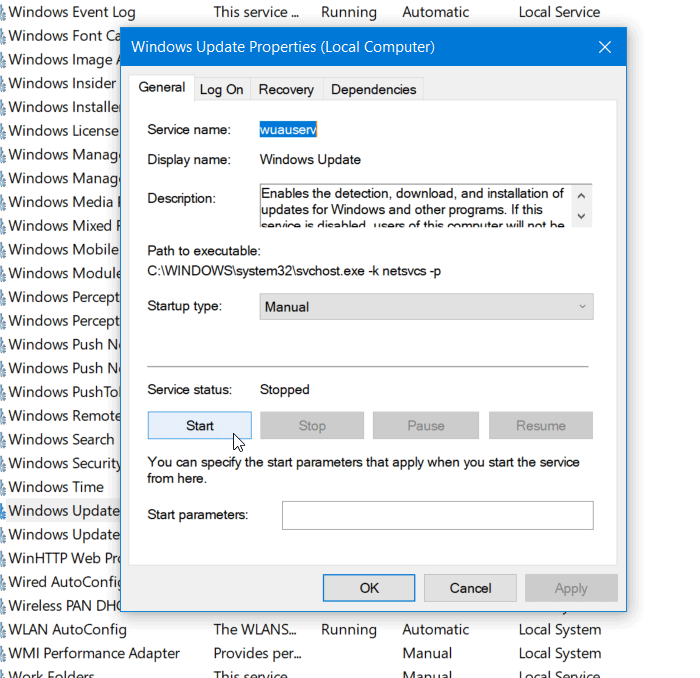

    1] Check if Windows Update related Services are running
    Open Windows Services Manager and check the Windows Update related Services like Windows Update, Windows Update Medic, Update Orchestrator Services, etc are not disabled.
    The default configuration on a standalone Windows 10 PC is as follows:
    • Windows Update Service – Manual (Triggered)
    • Windows Update Medic Services – Manual
    • Cryptographic Services – Automatic
    • Background Intelligent Transfer Service – Manual
    • DCOM Server Process Launcher – Automatic
    • RPC Endpoint Mapper – Automatic
    • Windows Installer – Manual.
    Make sure that the Startup type is as mentioned above. This will ensure that the required Services are available.
    Apart from the direct service, you should find the dependencies of the Windows Update service and ensure if they are running or not.
    To get started, search for “services” in the Taskbar search box and click on the search result. After opening the Services window, find out Windows Update, DCOM Server Process Launcher, and RPC Endpoint Mapper. Check if they are running or not.
    If not, you need to start those services one after one. You may double-click on them to open their Properties box and then do it, or you may simply right-click on the Service name and select Start.

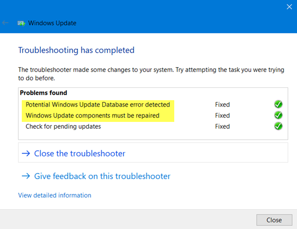

    3] Run Windows UpdateTroubleshooter
    Fix Windows Update error 0x80240061 windows-10-update-troubleshooter-600x464.png
    Use the Windows Update Troubleshooter from Microsoft. It resets Windows Updates settings to defaults.
    1. Go to Start button
    2. Select Settings
    3. Open Update & Security settings
    4. Locate Troubleshoot section
    5. From the Troubleshooters, select Windows Update.
    You may also run the Online Windows Troubleshooter from Microsoft.

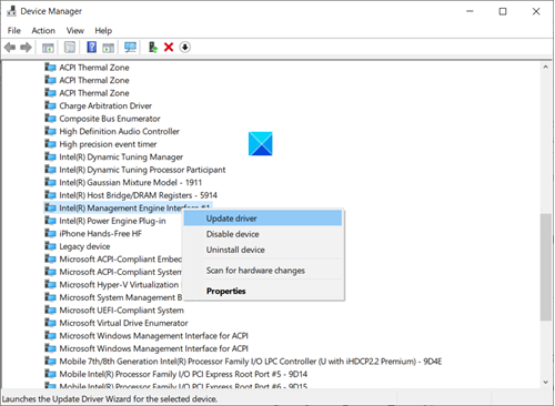

    5] Manually install the Update
    You need to manually download and install the update via the Microsoft Catalog site. The error message will display the KB number of the failed update.
    If it is the Intel Management Engine Interface that has failed, then do the following.
    Open Device Manager. Go to System Devices. Expand its menu.
    Fix Windows Update error 0x80240061 intel-management-engine-interface.png ​
    Find Intel(R) Management Engine Interface entry. When found, right-click it and select the Update Driver option.
    Hope it helps!
