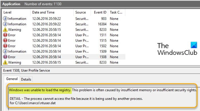

    If you encounter issues on your Windows 10 device, you may want to look in Event Viewer to get a better understanding of what the issue is and what might have caused it. On the course of that, you might see an event logged with the error message Windows was unable to load the registry. In this post, we will offer the most suitable solutions to this issue.
    Fix Windows was unable to load the registry error on Windows 10 Windows-was-unable-to-load-the-registry.jpg
    The following is the full error message;
    Windows was unable to load the registry. This problem is often caused by insufficient memory or insufficient security rights.
    DETAIL – The process cannot access the file because it is being used by another process, for C:\Users\<username>\ntuser.dat
    Most affected users didn’t report any associated symptoms with this issue (other than this recurring error message).
    The most likely culprits to this error includes;
    • Power interrupted during the logon/logoff procedure.
    • Bad application installed or uninstalled.
    • Network dropout or virus /spyware.
    • Corrupted UsrClass.dat profile.
    • Corrupted Windows profile.
    If you’re faced with this issue, you can try our recommended solutions below in no particular order and see if that helps to resolve the issue. But before you begin, restart your system once, log in as administrator and see if this makes the problem go away – as the error message does mention that it could be a memory or permissions issue.
