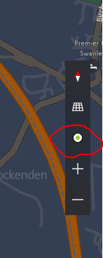

    I was frustrated that Windows was incorrectly reporting my location to my old address, despite updating my default location in Maps, and Google correctly locating my new home address. This is not about the locale detection, but the fine grained location services in Windows. I have seen NUMEROUS threads about this issue, which are allLOCKED so I cannot reply to them. It seems rather than answering the question, Microsoft's default position is to simply wait till enough people complain thenlock the thread.
    I found the answer that worked for me. Among other things, Windows uses wifi mac addresses broadcast by nearby Wifi routers. If you or someone in your immediate vicinity has moved into the area recently and your WLAN card can detect their access point regardless of if you are using a wired or wireless connection then it could determine the last updated location of this and assume your computer is somewhere else, possibly in the next city or state. The answer is to remove the mac addresses of any known APs in the area from Microsoft's global MAC address database. I found this here: https://support.microsoft.com/en-gb/help/4468240/windows-10-location-service-and-privacy. The actual page you need to visit is "Opt out of Location Services" here: http://go.microsoft.com/fwlink/?LinkId=223681
    To find mac addresses of the Wifi APs in your area:
    1. Objective: Any access points you know for certain have been used in another location need to be removed from Microsoft's database
    2. On an Android device, download and run Wifi Analyzer by farproc
    3. Expand each network. You will see a MAC address against each network like ab:12:34:ab:cd:ef.
    4. Write a list of mac addresses you need to remove - if you have a NEW router from your ISP, you don't need to remove these, only for ones that aren't new or your neighbour's ones
    5. Visit http://go.microsoft.com/fwlink/?LinkId=223681 and enter the mac addresses you need to have removed
    6. Wait a few minutes
    7. Turn off your wifi adaptor and go into Microsoft Maps
    8. Press the "Show my location" button - the round circle [FIXED] - Wrong location detected by Windows / Cortana / Maps 2d7a4864-8c3f-40d0-a251-38182541b3e2?upload=true.png
    9. Hopefully it will show your ACTUAL location - if not, you need to update your default location - Press "Default Location" and set it correctly
    10. Turn your wifi adaptor back on
    11. Reboot your computer
    12. Go back into Maps and press the "Show my location" button. Hopefully it now shows your correct location!!!
