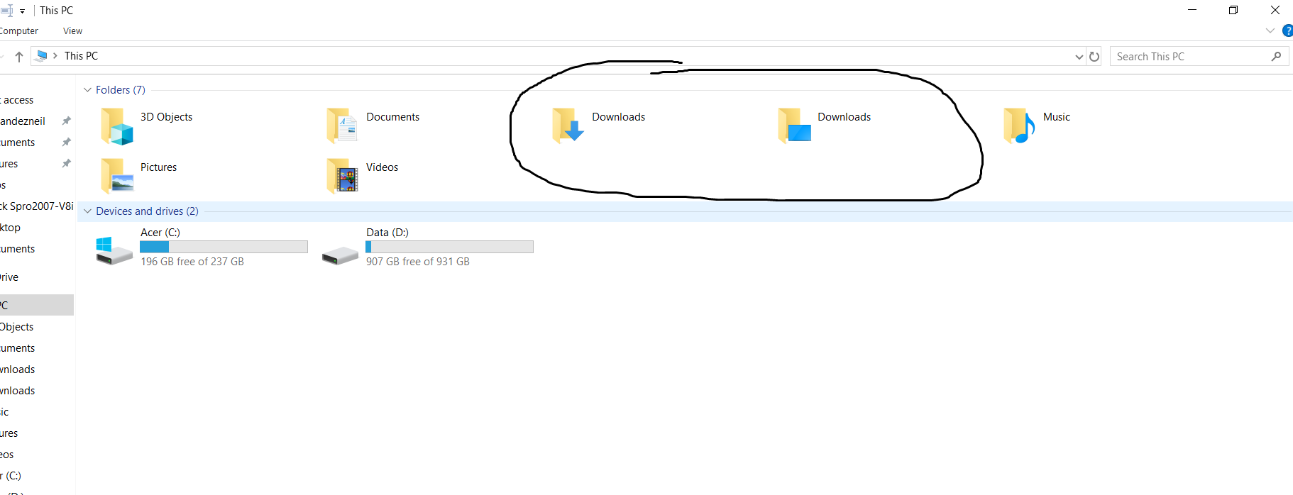

    Hi !
    I tried transferring the Location of my Downloads and Desktop folder to Drive "D" by changing its property location. But, after doing it, it seems that the Desktop folder renames itself to "downloads" and all the files that pertains from the download will also be viewed on the desktop. Then i tried again by renaming the folder to be back to desktop thru its location properties but, both the download folder and desktop folder renames itself to both "Desktop". And i try the other way around but still of no effect and i don't know how to fix it.
    I tried resetting it and although its back to its original name but they both share the same files. So, Please help.
    Best regards, Folder name and Location problem 4d6f44c3-2893-4908-bd98-4020d2de8977?upload=true.png

  4. Folder name and Location problem
    Downloads folder is the Documents folder
    Hi Chris,
    I suggest you to Restore to Default the folders and document settings and see if it helps.
    Step 1:
    Please follow below steps and check if it helps.
    • Go to Download folder.
    • Right click on the Download Folder and go to Properties.
    • In Properties go to Location tab.
    • In location Tab Click on Restore Default.
    Step 2:
    • Go to Documents folder.
    • Right click on the Document folder and go to Properties.
    After performing above steps change the settings as you required and check if it helps.
    Hope these information helps, please get back to us for future support, we’ll be glad to assist you further.
    Prabhavathi Patil, Jan 20, 2020
