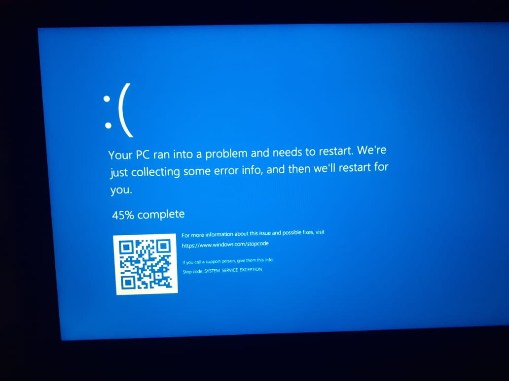

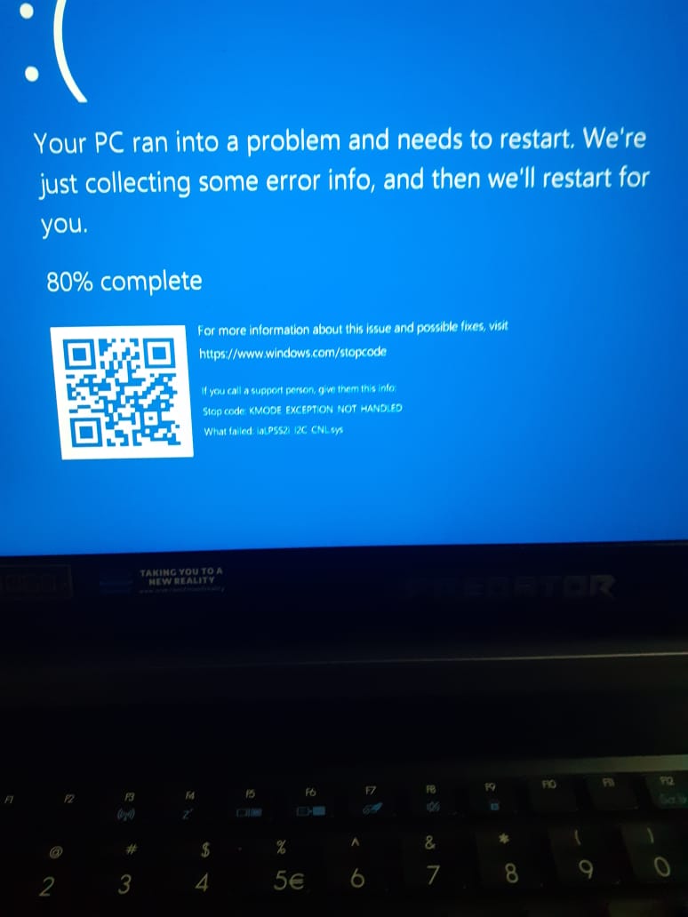

    I recently updated windows to 1903 10.0.18362 and now after one week I am facing a lot of BSOD. I have reset windows but still I get the BSOD.
    Sometimes I am not even able to get into windows as it automatically goes into automatic repair. But somehow after many attempts I am able to open the os.
    Below are some of the errors i get. I usually get a lot and each time its different. Frequent BSOD and each time a different error code ce98177f-840a-477e-a0e0-67fb8e975cec?upload=true.jpg Frequent BSOD and each time a different error code c6ebceb3-fdd2-4919-a30c-fad764b342f2?upload=true.jpg

    The log files that you provided only show one crash dump file so there is not a lot of information to go on. Furthermore the bugcheck code is not one I have ever seen before!
    The stack recorded in the dump includes some references to storage and the analysis suggests memory corruption and so with nothing else to go on I would suggest that you do a check on the hard disk and RAM. This maybe the same as you have already run but it would be good to see the results.
    Try CHKDSK
    using option 3
    Then
    Diagnostics Test [/i] HDD TEST
    *Arrow Run HDTune to
    • check the health,
    • scan for errors, no quick scan but full scan
    • run a benchmark.
    It may take some time, but please take the time you need to perform it properly.
    When above is done please make screenshots of the following
    • the health,
    • the error scan,
    • the benchmark incl. following
      • transfer rate,
      • access time,
      • burst rate,
      • cpu usage.
    Similarly with a memory test it would be good to post the results after you have run memtest86+ for a minimum of 8 passes
    You indicated that many more crashes have occurred, however, they are not being recorded. Please make sure that your system is setup to record crash dump files: Configure Windows 10 to Create Minidump on BSOD
    If the BSOD errors are all different it does tend to suggest a hardware problem. Sorry I can't be more helpful.
