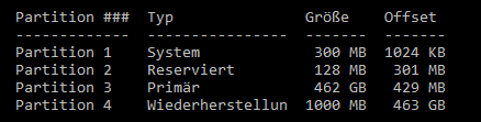

    I wiped the 500 GB clean now even with MiniTool Partition Wizard placing zeros and installed Windows on it with an USB, which was prepared via the Media Creation Tool. I tried it with letting Windows setup my GPT clean Command via Diskpart and then "New" Button when in Windows Setup and with manually creating it 300MB System EFI, 128MB MSR, REST Windows, 1000MB Windows RE tool. Both methods give me the same error result. While installing Windows I had only the 500GB SSD plugged in with SATA. No other disk was plugged in.
    Fresh Windows install on SSD with GPT wont Boot aab670ac-43cd-492a-a5f2-713ff640499b?upload=true.png
    After the installation the PC restarts and I get a black screen with a white underscore blinking. After some time, it switches to UEFI. When I disable Legacy Support in UEFI then I get an Error Message from UEFI that Legacy Support is disabled instead of the black screen with the white cursor. Usually this means that the Disk is in MBR Format but as you read, I prepared it the right way. So somehow my UEFI does not recognize the Windows Manager on the EFI Partition.
    I also disabled Secure Boot. Checked that AHCI is enabled. Updated the UEFI on the MoBo. Did a CMOS reset. The Disk while installing is on the first SATA Port and like said the only one used. I tried the same asdescribed with the 1000 GB SSD and had exactly the same result. However, when I started first, I was stupid and formatted the 125 GB as well before the I installed Windows on the 500GB. For a moment I had no Backup Disk with a running OS. But I managed to reinstall Windows on the 125 GB just fine. I dont understand why I cant get those 500GB and 1000GB SSDs to run Windows.
