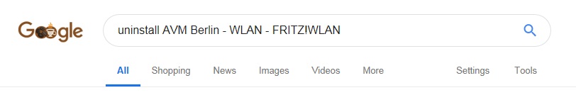

    When I performed a Google search like this:
    Fritz Wlan Usb Stick is not recognized? 394f2e36-4fa2-4ea4-824d-82801e78d466?upload=true.jpg
    ...turned up these instructions:
    Knowledge Base
    Did none of your Google searches return usable results?
    Copy and paste from that link:

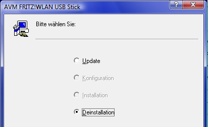

    1 Using the latest driver to uninstall
    1. Download the latest driver for your FRITZ!WLAN Stick from our FTP server
      ftp://ftp.avm.de/archive/cardware/
    2. Run the downloaded file "avm_fritz!wlan_usb_stick....exe" (double-click the file in the Windows Explorer, for example).
    3. Click "Yes" and "Next" until the window "Welcome to the Windows setup for the AVM FRITZ!WLAN USB Stick" appears.
    4. Click "Continue" and select "Removal" in the next window. If you cannot select "Removal", then the driver has not been installed yet. In this case, click "Cancel".
      Fig.: Using the latest driver to uninstall the FRITZ!WLAN Stick
    5. Confirm with "Next".

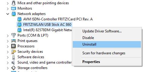

    2 Using the Windows Device Manager to uninstall
    1. Press the keyboard shortcut Windows key
      + Pause key.
      • The window with basic information about your computer opens.
    2. Click "Device Manager".
    3. Open the device class "Network adapters".
    4. Right-click "AVM FRITZ!WLAN USB Stick" and select "Uninstall".
      Fig.: Using the Device Manager to uninstall the FRITZ!WLAN Stick
    5. Follow the instructions.
