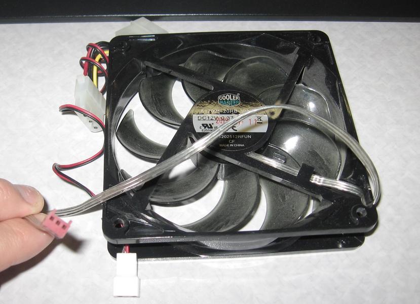

    Hi I have this question today, I want to replace the 4 1/2" fan in front of my case, the original one is making a bit of noise at startup.
    The original fan is a Coolermaster 12v 0.16 amps and it's connected through molex power directly, it has no control but it's a very quiet fan.
    The replacement fan I have here is a Coolermaster also, 12v but that one is .37 amps, and when I connect it through Molex, it like a airplane propeller, it's very noisy and way too strong for nothing.
    This is it here:
    Front case 4 1/2" fan replacement QonVOaA.jpg

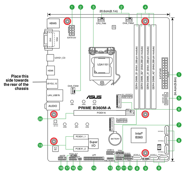

    So I was told these fans can be connected into the mother directly to control their speed and.. in hope of getting much lower RPM just like my 0.16 amps.. to get a quiet computer. But the wire itself is simply too short to reach any of the CPU_Fan connectors.. and it's not even the same type of connector. Those on the motherboard are 4 pins and my coolermaster fan is a 3 pins connector.
    My CPU is connected on #2 CPU_fan (Left) and logically the front case fan would go on #2 (right).. or #2 Fan 1 bellow the CPU. Do you use some kind of converter, it needs an extension cord too. What should I do to have a success with this.
    Thanks

  3. case fan connectors
    If the fan has a 4 pin Molex and a 3 pin plug then the molex plugs into a power supply plug and the 3 pin plug feeds rotation info to the motherboard. You may need to replace the fan with a 4 pin connector like this
    Cooler Master: PWM Fan 120mm
