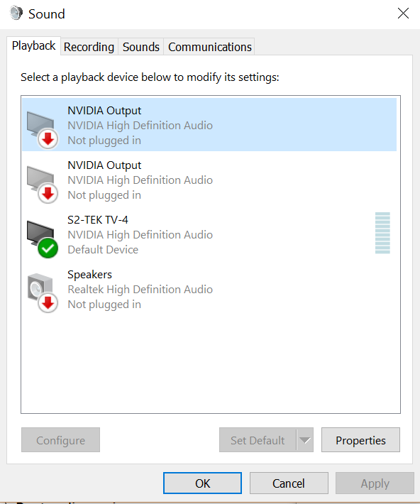

    After reinstalling Windows 10 and completely restoring my PC the audio jack stopped working.
    In the sounds it has a speaker option for
    1x Audio Jack -REAR PANEL
    3x Audio Jack -HDMI inputs
    but nothing for front audio jack. i tested the audio jack in the back it works fine and there is only 2x HDMI ports and only 1 works.
    I have tried deleting the audio drives and reinstalling but nothing.
    tried to check for an update.
    - The 3x NVIDIA Output description says located in HDMI.
    - The Speakers says location in rear panel..
    trouble shoot only has options for THESE nothing for front panel
    Front Panel Audio Jack does not work. 847a558c-2062-43f8-baeb-af233dd30398?upload=true.png

    This can be due to software conflicts. To help you resolve the issue, change the settings in Realtek HD Audio Manager. Follow the steps below:
    • Open Realtek HD Audio Manager.
    • On the upper right corner, click the small folder icon.
    • Beside the Disable front panel jack detection, tick the box next to it.
    • Click OK.
    Once done, try if the headphones will now work and produce sounds.
    Give us an update with the result so we can provide further assistance.
