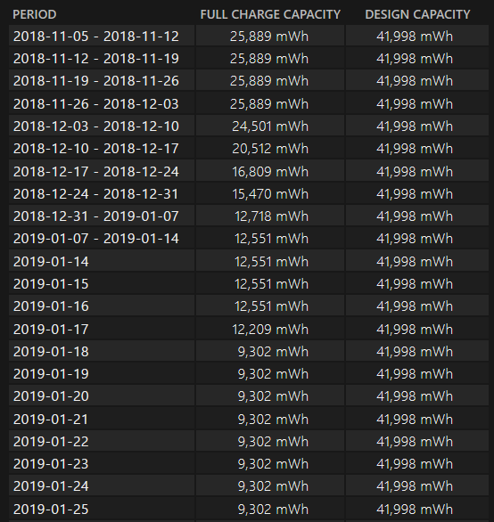

    Full charge capacity of battery decreased
    When I generated a battery report from cmd, I got this
    Full charge capacity of battery decreased 597cd3f0-c6c0-4bd4-a891-5f09ea798877?upload=true.png
    Full charge capacity of battery reduced drastically over a month's time. Is this the problem of OS or the battery has reached its end of life?
    vinay_45, Jan 27, 2019

    "Full charge capacity" means the capacity that the battery is managing to achieve. It is not a limit set by Windows or anything else; it is merely a reading of what the battery can actually do. You can use the comparison of Full charge capacity with Design
    capacity to decide when to buy a replacement battery [I do the same regularly].
    Full charge capacity will always decrease over time as the battery wears out. This is a chemical phenomenon not a Windows-imposed characteristic.
    Windows display of "Fully charged [100%]" means - the battery is currently at 100% of what it is able to achieve. In other words, "Fully charged [100%]" is relative to Full charge capacity.
    Sometimes, you can find that cycling through the battery three times** can improve the Full charge capacity a bit.
    On at least one of my batteries, the maker recommends doing this every three months. But doing so is using up even more of its remaining life so you can complete this procedure only to find that you are worse off afterwards.
    ** In other words, loop through this three times -
    • remove the AC power
    • use up the whole charge by using the computer
    • recharge fully
    Denis
