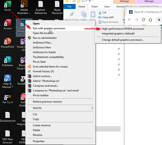

  4. DaveM121 Win User
    Games and applications are not using laptop dedicated GPU after November update
    My laptop wont fully run on dedicated GPU
    Hi Radu
    There is no longer a way to get Windows 10 to run on the dedicated GPU, Nvidia removes the Optimus option which allowed us to just use the Nvidia card and ignore the integrated Intel graphics option . . .
    On your Desktop, right click a Desktop shortcut for a game or application, on the resulting menu, do you get the option to set that to run on the Dedicated graphics?
    Games and applications are not using laptop dedicated GPU after November update 43c79b38-9acb-4240-ac7e-3ec92d6162e9?upload=true.png
    DaveM121, Dec 11, 2019
