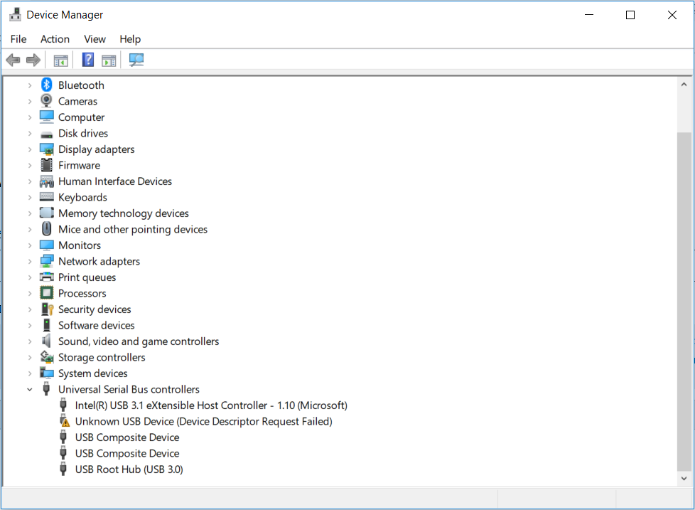

    I've been having issues with my USB ports and thought it may have been related to an issue I've had for some time now. This issue shows up as 'Unknown USB Device (Device Descriptor Request Failed)' in the device manager. In an effort to resolve this problem, I've attempted a few fixes found online. I have tried hardware troubleshooting, power plan editing, and turning off fast startup, all with no results. Some fixes online involve a device called 'Generic USB Hub', but that device does not appear in my device manager. Is there a reason it isn't appearing or does it need to be installed? If it needs to be installed, how would I go about doing that? Generic USB Hub Device Missing 8d52bd9d-f579-45f3-b7b5-2be6e89891de?upload=true.png

    • Can you access the USB from Windows explorer?
    Windows has stopped this device because it has reported problems. (Code 43), this error is an indication of corrupted loaded drivers. By default, Device Manager only displays drivers of
    connected devices, sometimes windows can get "confused" with the old drivers in the system. I suggest you to follow the steps mentioned below and let us know if it is fixed.
    Method 1: Install Generic driver.
    1. Connect one of the USB hubs.
    2. Press Windows and
      R key together on your Keyboard.
    3. Type devmgmt.msc and hit enter.
    4. Right click on the Generic super speed USB hub.
    5. Click on Update Driver.
    6. Click on Browse my computer.
    7. Select Browse, navigate to: C:\Windows\winsxs when it asks for the driver location.
    8. Click on Install to install the Windows generic file.
    Method 2: Uninstall and reinstall Driver.
    I would suggest you to follow the steps
    provide by Aswin_Ananad on 6th April 2016. For more information, check the Microsoft article on
    USB Device not recognized.
    Let us know if you need further assistance regarding this issue.

    Incompatible USB hub driver is one of the possible reasons why this issue is happening. We recommend uninstalling the USB Root Hub driver and see if it helps. Follow the stepes below:
    • Open Device Manager.
    • Double-click Universal Serial Bus controllers to expand.
    • Right-click USB Root Hub, then click Properties.
    • Go to the Driver tab.
    • Click Uninstall.
    • Restart your computer.
    Note: Restarting your computer will automatically reinstall a generic driver for your computer. Also, we suggest connecting your USB hub while performing the steps.
    If the issue still persists, let's disable the USB selective suspend settings thru Power Options to resolve the issue. Follow the steps below:
    • Type Power Options in the search box, then press Enter.
    • Locate USB settings > USB selective suspend settings.
    • Select Disable.
    Keep us in the loop with the result.
