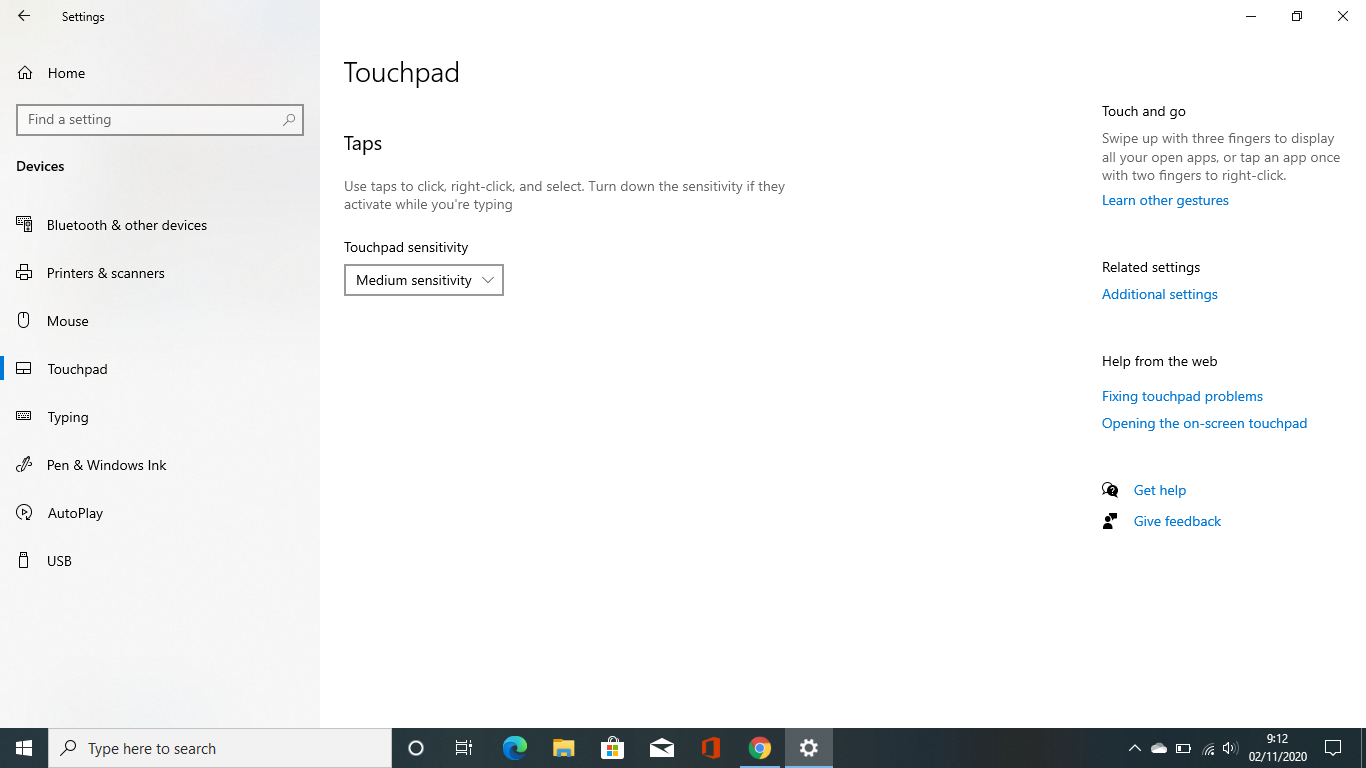

    I have laptop Acer Aspire E 14 E5-476G
    my touchpad gesture is not working after I have reinstalled the window 10 pro by bootable usb.
    how to fix it now?
    Gesture on the touchpad is missing c07419b9-8c76-47a9-87cc-8c89dec4d9a5?upload=true.png
    athallaarnaz, Nov 1, 2020

    Hello, Does your touchpad work except for gestures ?
    I suggest you install the touchpad driver from your PC manufacturer.

    touchpad gestures two finger scroll not working Asus 501
    Hi there,
    1. Go to N501VW | ASUS Global Downloads
    2. Download the latest ATK - ATKPackage driver
    3. Download the latest TouchPad - ASUS Smart Gesture (Touchpad Driver)
    4. Uninstall both the Touchpad driver and the Asus ATK package driver.
    5. Reboot
    6. First install ATKPackage driver (IMPORTANT to do this FIRST)
    7. Reboot
    8. Then install the TouchPad driver (may need to reboot)
    9. Test if all is working as it should
    I had this same issue with my Asus UX305 when I upgraded to Windows version 1803 and doing the above steps solved the issue for me.
    slicendice, Nov 1, 2020
