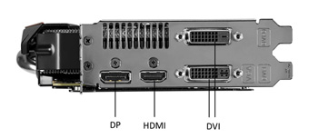

    2: Check if you selected the correct input source
    If your didn’t select the correct input source for your monitor, you will also get the monitor no signal issue. Before you select the correct input source for your monitor, you need to know what ports your PC and the monitor have.
    DP, HDMI, DVI, VGA
