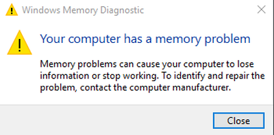

    Hi, I am getting the BSOD issues which is very annoying. Can you please help me to fix this issue. I am providing you the minidumps files, system info and specification files so you can identify the problem with my pc.
    Moreover, I also run the Windows Memory Diagnostic and it says.
    Getting BSOD with different codes frequently 0c4752dd-2fc9-409f-9e42-72bc293c15ca?upload=true.png

    The log files that you provided only show one crash dump file so there is not a lot of information to go on. Furthermore the bugcheck code is not one I have ever seen before!
    The stack recorded in the dump includes some references to storage and the analysis suggests memory corruption and so with nothing else to go on I would suggest that you do a check on the hard disk and RAM. This maybe the same as you have already run but it would be good to see the results.
    Try CHKDSK
    using option 3
    Then
    Diagnostics Test [/i] HDD TEST
    *Arrow Run HDTune to
    • check the health,
    • scan for errors, no quick scan but full scan
    • run a benchmark.
    It may take some time, but please take the time you need to perform it properly.
    When above is done please make screenshots of the following
    • the health,
    • the error scan,
    • the benchmark incl. following
      • transfer rate,
      • access time,
      • burst rate,
      • cpu usage.
    Similarly with a memory test it would be good to post the results after you have run memtest86+ for a minimum of 8 passes
    You indicated that many more crashes have occurred, however, they are not being recorded. Please make sure that your system is setup to record crash dump files: Configure Windows 10 to Create Minidump on BSOD
    If the BSOD errors are all different it does tend to suggest a hardware problem. Sorry I can't be more helpful.

    many different BSOD codes means some hardware problems.
    Please run Windows memory diagnostic in wide mode as a first step.
