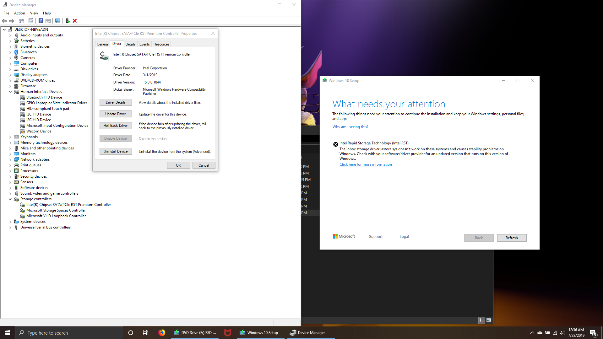

    getting intel rst error when repairing windows with the recommended version
    getting intel rst error when repairing windows with the recommended version 1a801646-dede-4fb5-861a-551a418339df?upload=true.png
    as you can see by this screenshot i am triggering the intel RST compatibility hold even though i have the exact version they recommend on the support article
    i did something very stupid and deleted the windows store entirely so i really need a repair and this couldn't be a worse time to have this issue
    anyone got a fix?

  2. Nikhar_K Win User
    Intel RST service is not running
    The Intel RST service is for the Intel Rapid Storage Driver. The Intel Rapid Storage Driver provides speed for data transfer and improves the performance for SATA drives or PCIe drives.
    • What is the make and model of the computer and motherboard?
    You can follow the methods mentioned below and check if that helps:
    Method 1: Changing the startup type for Service
    You can try changing the startup type for the Intel RST service and check if that makes a difference. Please refer the steps mentioned below:
    1. Press and hold Windows key + R, to open
      Run dialog box.
    2. Type serivces.msc and click on
      OK
    3. Now, scroll down, look for Intel RST service, right click on it and click on
      Properties.
    4. Now, under startup type select Automatic from the drop down menu.
    5. Click on Apply and OK.
    Method 2: Updating the drivers manually
    You can try downloading the latest version of Intel Rapid Storage Driver from the
    Intel Website
    and check if that helps. However, I would suggest checking with the motherboard manufacturer website as well.
    If you are using RAID configuration, I suggest you to post your query in
    TechNet forums
    , where we have support professionals who are well equipped with the knowledge on RAID configuration.
