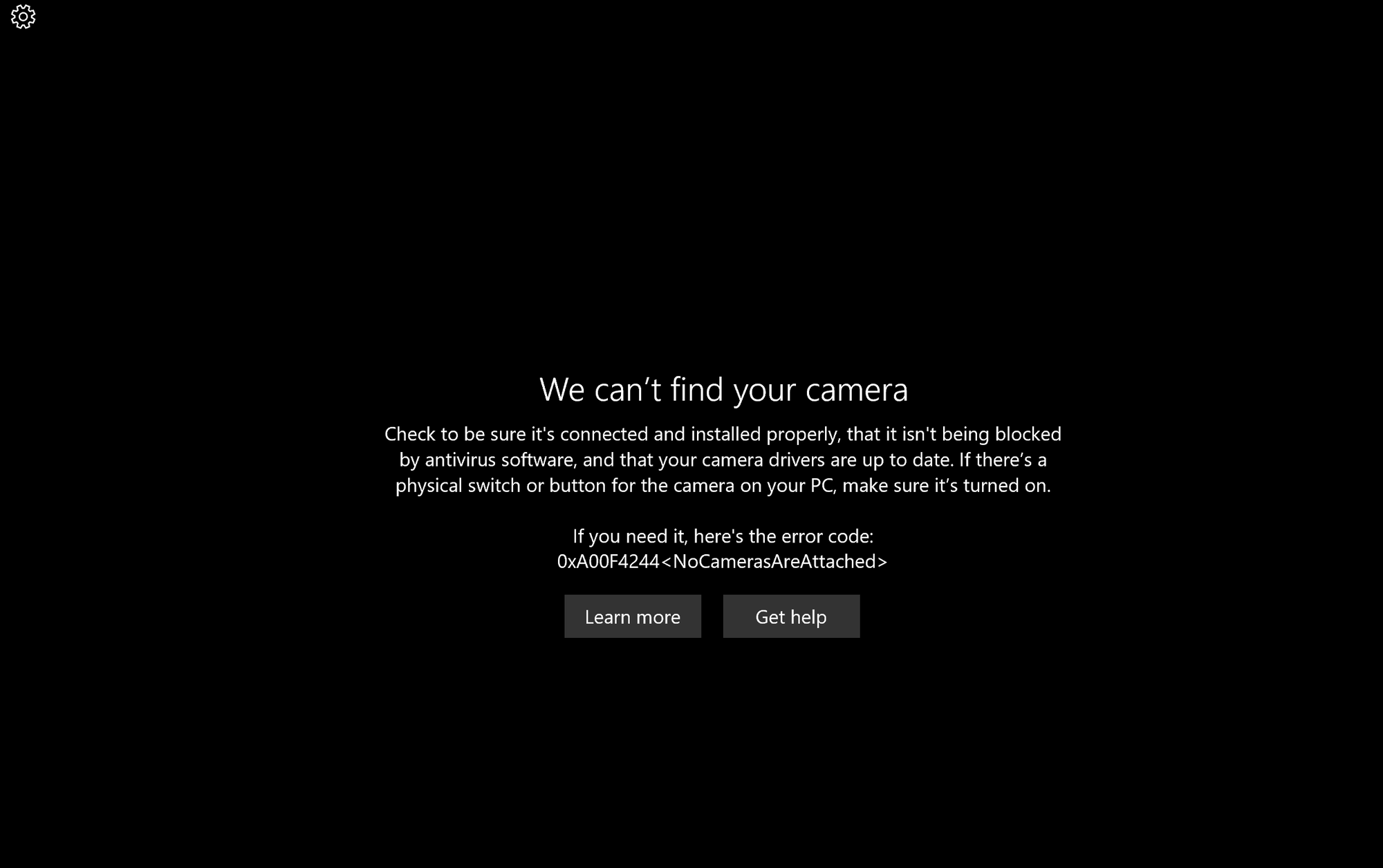

    Getting We Can't Find Your Camera Error 0xA00F4244 and Unable to Use Webcam
    I am receiving the subject error, and as a result am not able to use my webcam. Computer in an HP Envy x360 laptop and I have tried fixing using the steps on HP's website with no success. One fix said that I should reset Windows, however I was hesitant to do that as I did not have experience doing so and cannot lose any files as this is a work laptop.

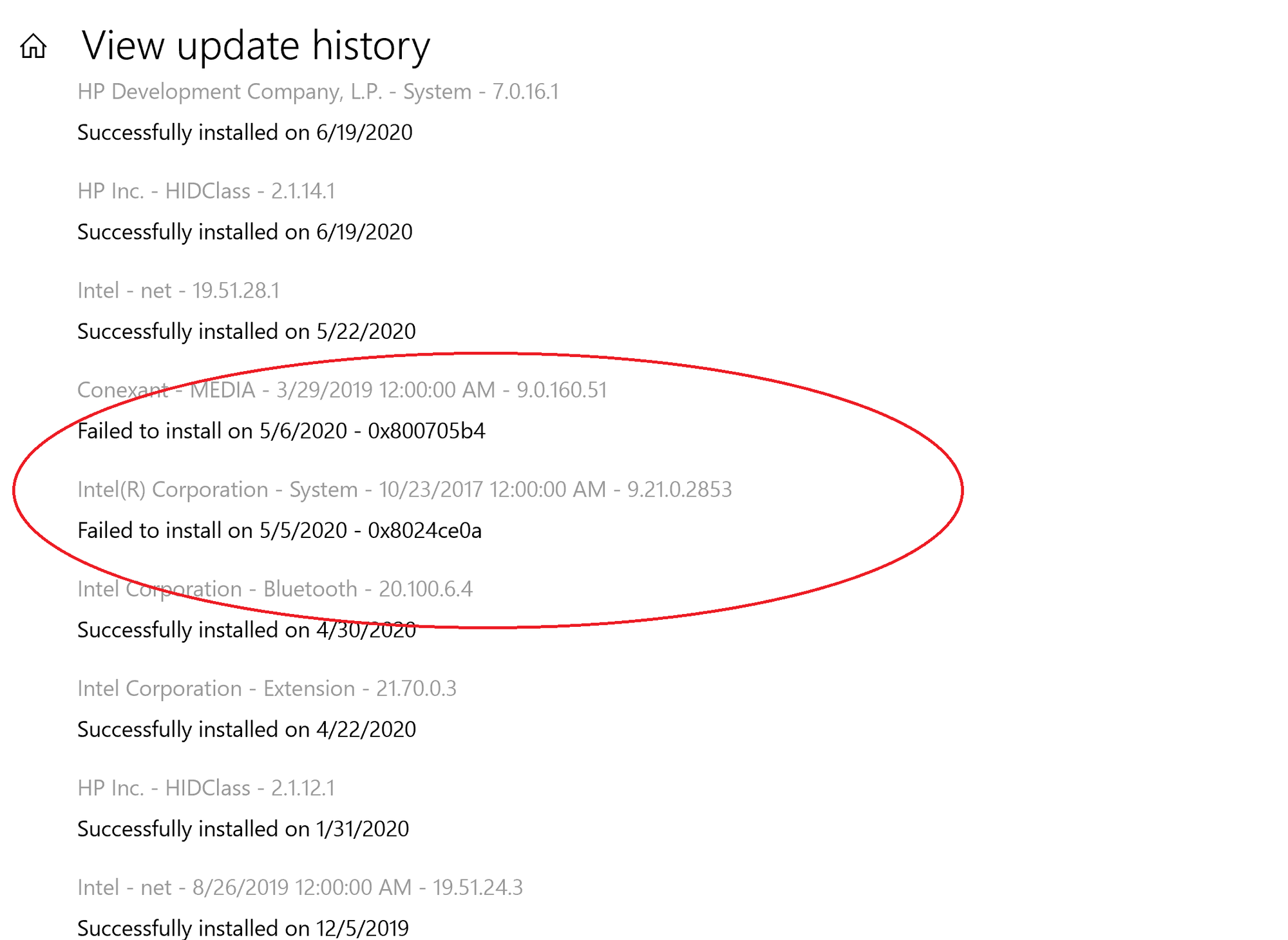

    I also saw that a few driver updates and a Windows update had not successfully completed in the past. One user mentioned this working for him, however I was not able to successfully install these updates manually when I tried, maybe due to user error.

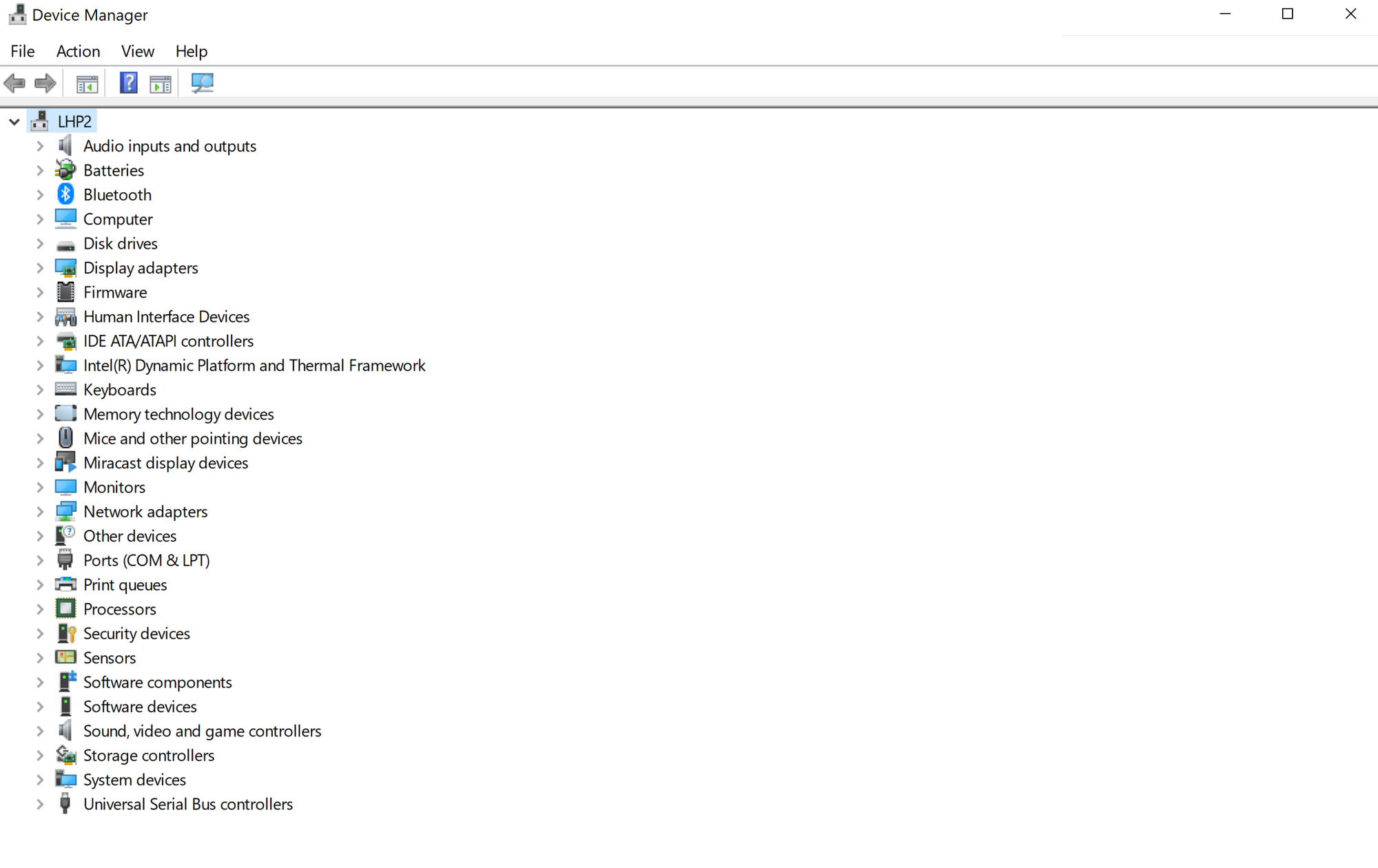

    My Camera also does not show up at all in Device Manager.
    Really appreciate any help. I have attached screenshots for reference.

  2. Cliff S Win User
    Error 0xA00F4244<NoCamerasAreAttached> for Microsoft webcam
    You can try using the windows default driver.
    Right click the device in device manager, and select update, then browse for drivers my computer, then select let me pick from a list, then select USB Video device:
