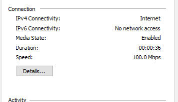

    So i just installed a Gigabit ethernet line through my house, i instantly noticed that when i do a speedtest i only get arround 90-100 mbps, so i checked device manager and it says "100 mbps" there on the ethernet adapter
    Gigabit Ethernet does not work 2b9bc5c6-bb0c-4f23-883c-d6ec924ec004?upload=true.png

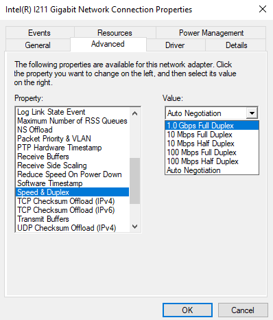

    However, i can select 1 Gigabit Ether on my Ethernet Adapter via Device manager
    Gigabit Ethernet does not work cff6d749-8228-4904-b2ab-496caaf25512?upload=true.png
    Which in theory tells me that my Ethernet is 1 Gigabit capable, but if i select it my ethernet will just be gone and the PC and i have to reset it to Auto Negition or 100 mbps again to make the internet work again.
    What could possibly cause the issue? I dont think its faulty wiring cause if the wires werent Gigabit wires which they are they are Cat 6 cables then i would not be able to select 1 Gbps.
