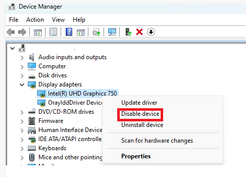

    1. In the search box on the taskbar, enter device manager, then select Device Manager.
    2. Right-click (or press and hold) the name of the device, and then select Uninstall.
    If that still doesn't resolve the issue, go to Device Manager to disable discrete graphics or disable integrated graphics to see if the problem goes away.
    gpu driver error 43 nNLQT4c0bieATbRwVzQk2xX57GYXn%2fA5xrOZADmp50y%2b1H6MKn%2f%2fYX0zianHTqnBLqCuCBJ7AO%2bHXYu5plU%3d.png
