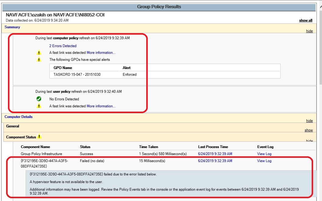

  4. -KELLY- Win User
    Group policy only works after "gpupdate /force"
    Error on gpupdate /force
    I got Windows 10 Enterprise version 1803, and it is client machine of our internal domain controller in our network.
    I just found out it showed up the error as below when I executed gpupdate /force from command prompt with Administrator permission.
    Updating policy...
    Computer Policy update has completed successfully.
    The following warnings were encountered during computer policy processing:
    Windows failed to apply the {F312195E-3D9D-447A-A3F5-08DFFA24735E} settings. {F312195E-3D9D-447A-A3F5-08DFFA24735E} settings might have its own log file. Please click on the "More information" link.
    User Policy update has completed successfully.
    For more detailed information, review the event log or run GPRESULT /H GPReport.html from the command line to access information about Group Policy results.
    When I execute gpresult /h gpresult.html, and confirm the result, there are 3 errors listed as below.
    Group policy only works after "gpupdate /force" 42a68422-bdef-4019-9a5c-fd0f732505d7?upload=true.jpg
    First 2 errors link to the following Microsoft article after clicking more information links.
    Understand the Effect of Fast Logon Optimization and Fast Startup on Group Policy
    The error at the bottom give these 3 event IDs after clicking view log links.
    (Event ID) 4016
    Starting {F312195E-3D9D-447A-A3F5-08DFFA24735E} Extension Processing. List of applicable Group Policy objects: (Changes were detected.)
    (Event ID) 1085
    (Event ID) 7016
    Completed {F312195E-3D9D-447A-A3F5-08DFFA24735E} Extension Processing in 15 milliseconds.
    First of all I would like to identify what kind of group pollicy the "F312195E-3D9D-447A-A3F5-08DFFA24735E" is. I believe it is under the computer configuration, but there are a lot. How can I search it?
    Also if there is any action I should take next for these links, any advice will be appreciated..
    -KELLY-, Mar 6, 2020
