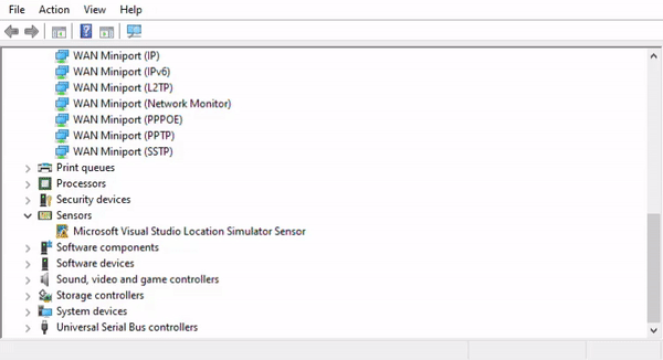

    Ok, this is the thing: I have to use a device which has a FTDI FT245 chip. On other computers, this device works fine. So, I need to attach it to my work Windows 10 PC.
    However: when I attach it, at first, the device is detected - as typical for FTDI based devices - as USB Serial Port (COM3) node under a Ports (COM & LPT) node in Device Manager. And then it hangs there for around 10 seconds; and then I hear the Windows 10 disconnect sound - and it disappears from Device Manager! Here is video/animated gif capture of Device Manager in that case:
    When I plug the device, the Device Manager tree refreshes at first and shows the node, and then when it refreshes the second time (when the node disappears), I do absolutely nothing.

    And one more thing - I've had the device plugged in the USB 3 hub, after the device node disappeared; then I uninstalled some unrelated (video editor) program, and by accident, I looked at the hub, and saw its LED steady on (it otherwise shuts off when the node disappears) - and it persisted in that state for like a minute or so; but as soon as I tried to run a program that should talk to the FTDI chip on the device, the device node disappeared again. This was the only instance so far, where the device node stayed in Device Manager for longer than the 10 seconds or so, as shown on the video - every other instance of plugging in this FTDI based device showed behavior as on the gif/vidfeo.
