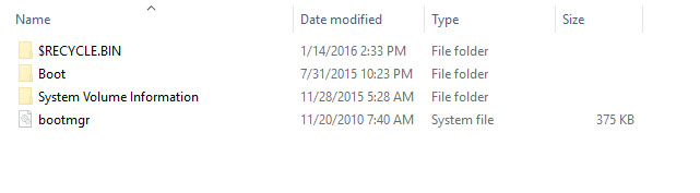

    This
    is all that's in it. When I select everything it comes to no where near the 100mb. about 15mb. Yet Disk management says only 2mb

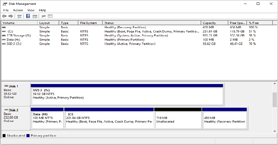

    remain. Can I get rid of this partition? Or is there a way to extend the partition so I stop getting the messages? Ive tried shrinking the C: drive partition to extend the data(HH: 100mb system partition? :) partition but it stays greyed out.

    If it's the system partition, it typically contains your boot information for starting the computer. It doesn't typically get assigned a drive letter. You can press [Windows key + x] select "Disk Management". If you see the H drive with the label "system partition" then that is all it is. Assuming the partition is on your main disk (Disk 0) you can remove the drive letter as follows
    • Open an elevated command prompt
    • Type diskpart
    • Type list disk
    • Identify which disk the system partition is on (you can do this from disk management)
    • Select the disk withselect disk #
    • Now list the partitions with list vol
    • Look for the one with System under the info column
    • Select it with select vol #
    • Now remove the drive letter with ​remove letter=H
    Neemobeer, Sep 19, 2020
