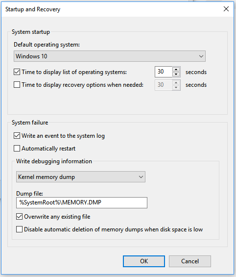

    I recently got a Blue Screen of Death on my Windows 10 laptop. I took a photo of the QR code, but it took me to a generic and useless Microsoft web page. My QR code app only keeps a history of the links, not the photos, so I do not remember what the stop code was.
    I want to know why this BSOD occurred and if it might be a hardware or software problem. Here is how I have the crash handling configured:
    Had 3 BSOD's today, can anyone help narrow down a fix by reading the dump logs N5kw2.png
    As you can see, the "Write an event to the system log" box is checked, and a dump file named C:\WINDOWS\MEMORY.DMP should be created.
    However, when I looked at the System log in Event Viewer, I didn't see anything that seemed related to the BSOD around the time of the crash. I read that there should be an entry from Source "BugCheck" for a BSOD, so I tried to filter the events with "Event sources"=BugCheck, but nothing was found.
    There is also no file under C:\WINDOWS named MEMORY.DMP.
    Why did Windows 10 not put an entry in the system log for the BSOD, and why didn't it create a dump file? How else might I be able to determine what the bugcheck code was, and what caused it?
    EDIT: Additional information:
    • There is over 300 GB of free disk space on the C drive, so a lack of space is not the reason why the dump file wasn't created.
    pacoverflow, Oct 27, 2019
