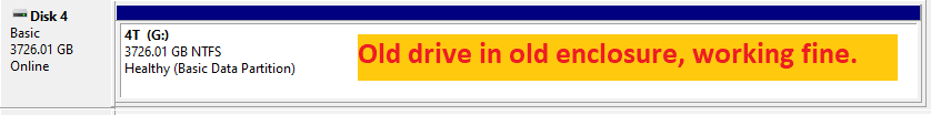

    My issue is when I remove my old drive from the old single bay enclosure, and put it into the new 4-bay enclosure, windows does not list this drive in file explorer. Even though it was formatted and working fine. I can put the old drive back into the old single bay enclosure and it shows up again just like it had been working before. Here is a screenshot from disk manager of the old drive in the old enclosure.

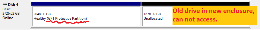

    When I put the old drive into the new SC4B enclosure and go to disk management it does show the drive there. However, the drive does not have a drive letter assigned. It changes some info as well. There are two partitions shown. And it lists it as "GPT Protective Partition"

  3. Hard drive not working in one external enclosure but does in another
    I've seen this problem before. A lot of enclosures write a proprietary "layer" onto the drive so that the drives work in the enclosure no matter what the sector size or the limitations of the master boot record. Unfortunately, that means that when you put the drive in a new enclosure, it won't work because the proprietary "layer" is from a different enclosure type.
    I am guessing that is what is happening here despite being from the same manufacturer.
    Move your data off the drive and reformat it on the 4 bay enclosure. I bet it will work, and you will have confirmed my suspicion. If not, we can try something else.
