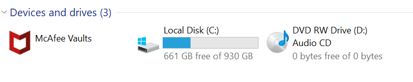

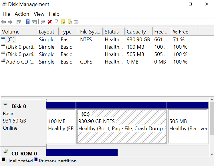

    My new 1TB Seagate portable hard drive is no longer showing up in Windows Explorer, or in Disk Management. But I very clearly see it recognized in Device Manager and I also see the button to eject it in the lower right of my screen. What should I do to fix it?

    Is the Disk 0 in Disk Management what the hard drive is? But then shouldn't it say "Portable" or "Removable" instead of Basic?
