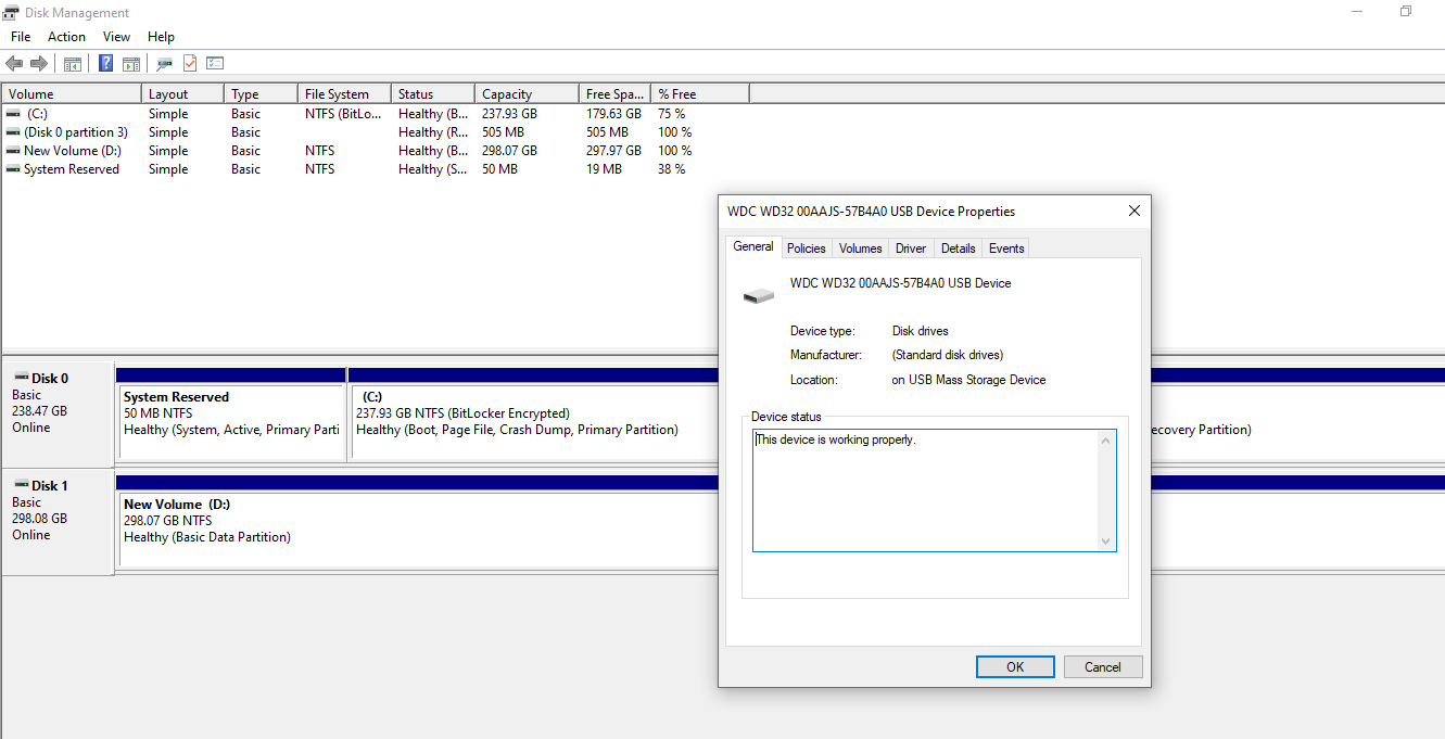

    Hello is there a way to enable a PUIS drive to spin up?

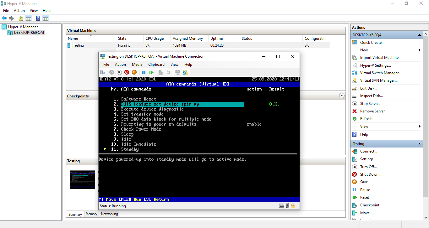

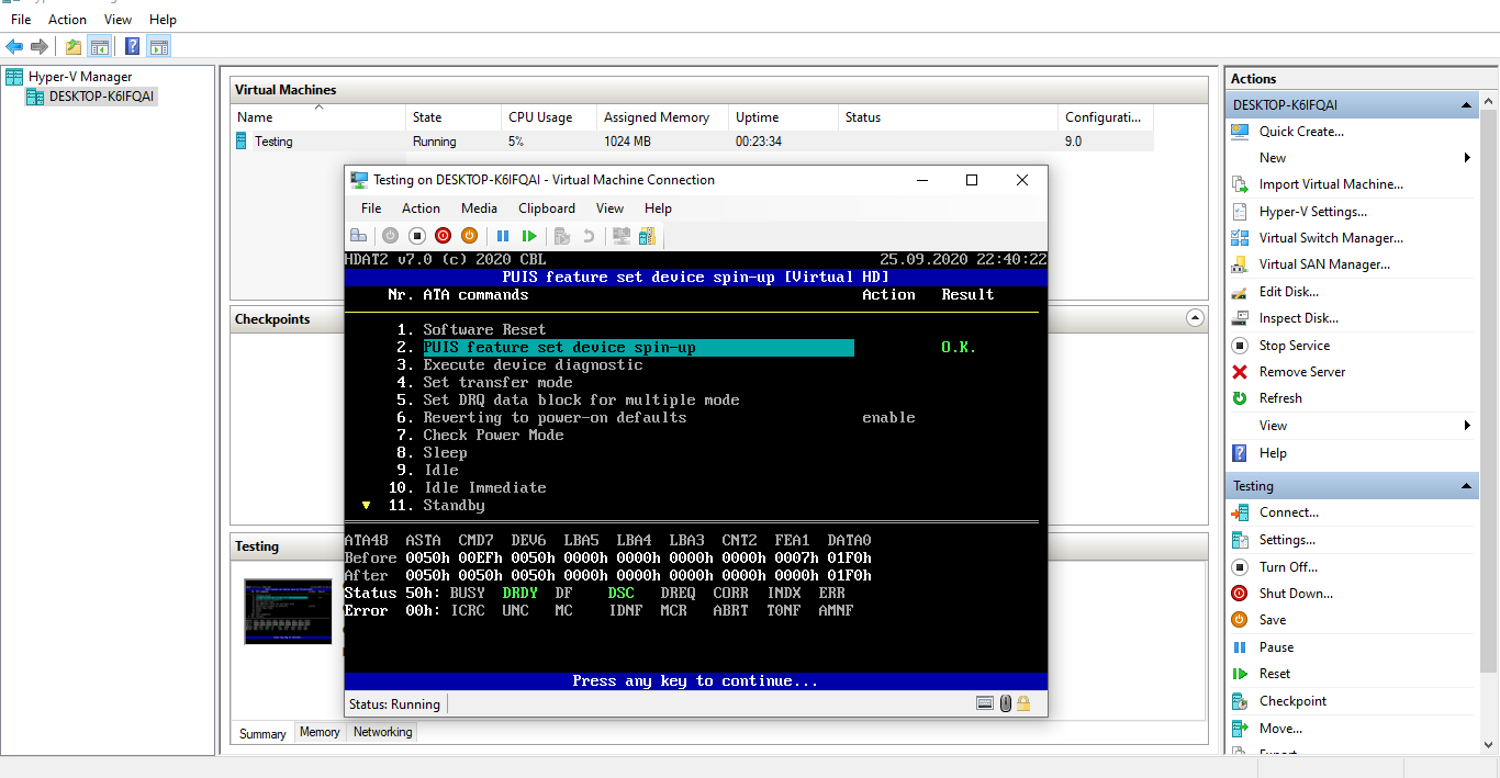

    I was able to do this only with using a system having it hot swapped to a SATA cable on the windows device. HDPARM did not work I had to use a VM of older dos boot disks to get to the amazing older ATA commands. Is there a ATA command set option under administrator log in to work with drives like this?
    I do not want to go threw all of this to just spin up a PUIS drive I even checked under the hard drive setting once it was powered. We used drives like this all the time in data centers. What if we need data off one for cyber security? I cant find a PUIS setting anywhere.
    I had to boot the other device that was able to power up the PUIS drive then hot plug the sata cable then format it, offline it boot up a VM with help from https://datarecovery.com/rd/how-to-unlock-dvr-hard-drives-for-normal-use-directv-dish-network/ to do this, I used a older dos era boot disk and was able to disable PUIS. I just wanted extra space from a older drive I have in a non useable DVR in the garage to use for storing VMs for educational use.
