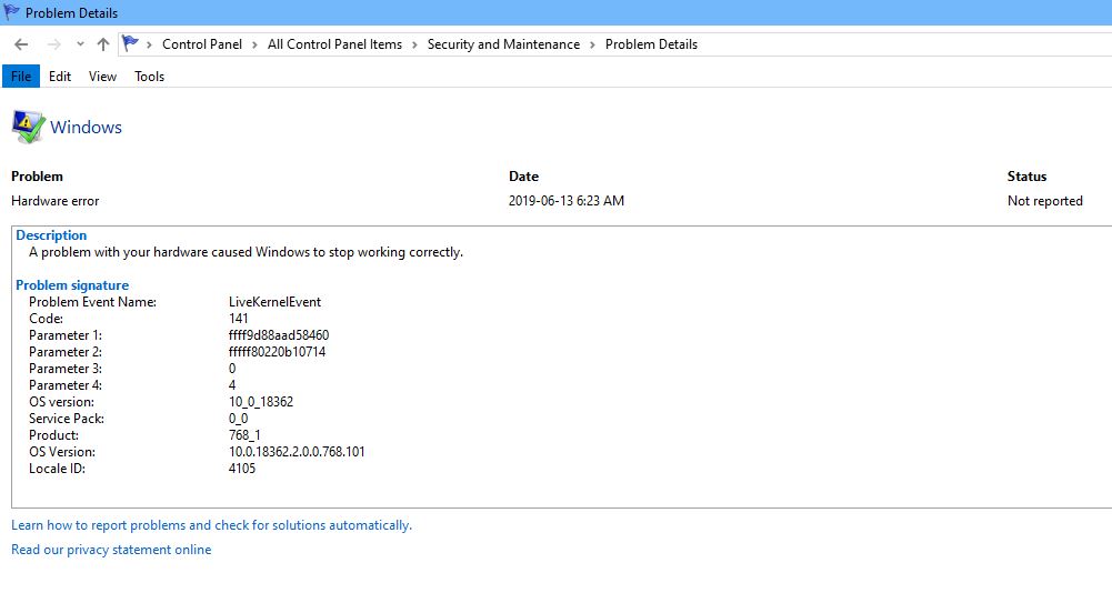

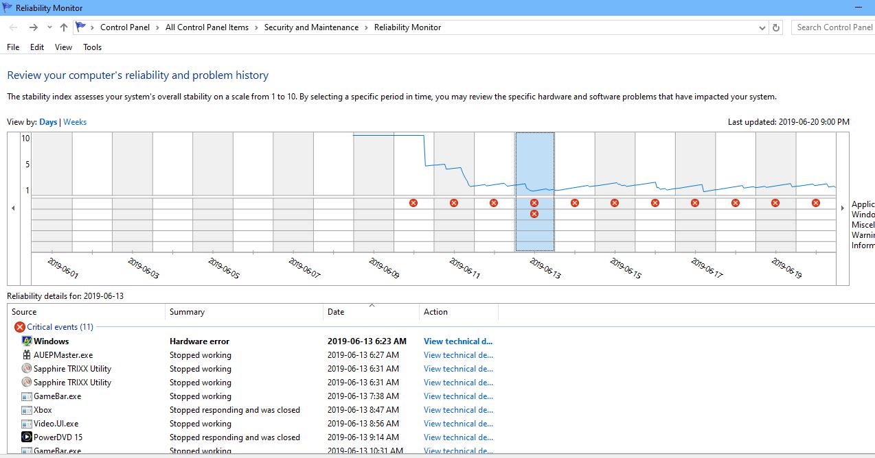

    Having some issues with my system, can some one help me figure this out?
    I am running the latest released build of windows (1903) which is how I got the reliability monitor (I do not think it was in the system before this update as the first entry was from June 10 2019).
    For the last few months I have been having issues sometimes(even a few times a week) where the computer powers on but cannot find the boot drive (a m.2 nvme chip) (sata mechanical hard drives show, but none are setup to boot). It takes a few min of tinkering to get it to find the boot drive again (sometimes unplugging external devices, or unplugging or plugging in another drive).
    I have a SSD as shown in the parts list but I have that as a unplugged backup boot drive, incase these issues become permanent form the NVME drive).
    Sometimes when this happens the USB ports stop responding and the video cuts out from my graphics card leaving me the only option to restart the system leading me to the above issue.
    I am trying to figure out if the entry in the Reliability monitor is related to this problem and also why it didn't get sent to Microsoft like all the software crashing entries do (Game Bar crashes A LOT according to this monitor).
    Hardware Error reported by windows 10 Reliability Monitor, very concerned. bea6d77e-367b-4fe3-8d05-69178094d744?upload=true.jpg
    Hardware Error reported by windows 10 Reliability Monitor, very concerned. 334ef65d-e2d4-494a-bef3-9add076e4cd7?upload=true.jpg
